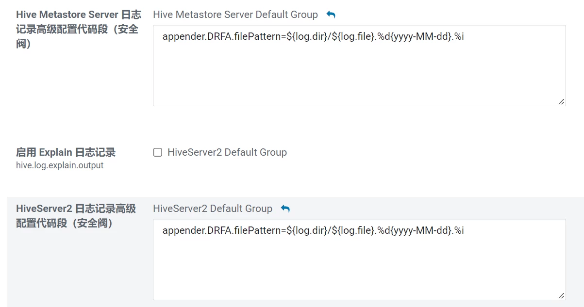

it should be like this,  appender.DRFA.filePattern=${log.dir}/${log.file}.%d{yyyy-MM-dd}.%i
and it will be working in CDH 6.2
Translate
tencentemr
Silver ⭐️⭐️⭐️
Nov 25, 2022 6:01 AM UTC
Translate
