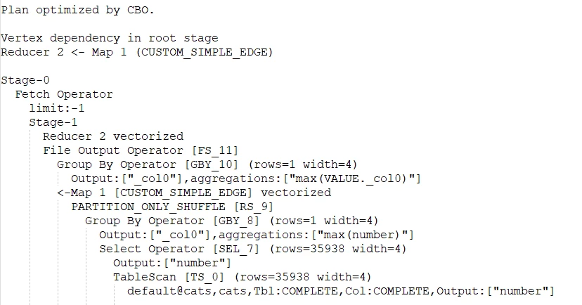

screenshot.PNGI have a parquet table named 'cats' holding 2 columns (day STRING, number INT). Statistics are generated both for the table and the 2 columns (e.g. max, min, distinct can be seen in DESCRIBE FORMATTED default.cats number).
Still, when running an explain command for a select max, it looks like the statistics aren't being used. Why is this? How can Hive be configured to use the stats?
All the following settings are true:
set hive.cbo.enable;
set hive.stats.autogather;
set hive.compute.query.using.stats;
set hive.stats.fetch.column.stats;
set hive.stats.fetch.partition.stats;
explain select max(number) from default.cats;

@smruti Column stats are available indeed: {\"BASIC_STATS\":\"true\",\"COLUMN_STATS\":{\"number\":\"true\"}}.
I extended the table size to 1gig+ (since hive.fetch.task.conversion.threshold=1073741824), and tried hive.fetch.task.aggr=true before doing the explain select for the max. It is unfortunately still doing a full TableScan as seen in the screenshot above. I would like to remark as well that we are talking about an external table here. When I put the same data in a managed table, the query plan makes use of stats as expected.
So in summary, I don't understand why stats arent being used for this external table.

@Leopold I just checked. Your observation is correct. For external tables, it does not use a fetch task. In the logs, I see the following message:
2024-03-12 10:48:37,247 INFO  org.apache.hadoop.hive.ql.optimizer.StatsOptimizer: [b226e7aa-9a42-4af3-b99b-be4a6592fb7f HiveServer2-Handler-Pool: Thread-31145]: Table t7 is external. Skip StatsOptimizer.
But enabling  "hive.fetch.task.aggr=true" will help avoid the Reducer phase that is used for final aggregation. It will be a Map-only job.

Thank you @smruti. Is there no way to enable the use of statistics for external tables in Hive?

@Leopold It is disabled for external tables as data in HDFS can change without Hive knowing about it.  Unfortunately I do not see a way to enforce fetch task for a query with an aggregate function.
