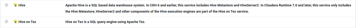

So many thanks Silvan... i think that i found the "issue" is in the traslation to Spanish of the interface:
In English the interface inform about hiveserver2 on Hive and Hive on Tez
But in Spanish not...
Any way i'll read the refered documentation... like i said is my first CDP... i intalled so many CDH in the pass... but is my first time with CDP.

Hello @Sergiete ,
thank you for raising our attention that there was an improvement point in Cloudera CDP documentation.
We have added clarification in our CDP documentation about "Installing Hive on Tez" [1] and that the Spark execution engine is not supported, as it's been replaced by Tez [2].
Based on our updated documentation [1] the correct order of installing the Hive service is:
  1. Install the Hive service, designated Hive on Tez in CDP.
    HiveServer is installed automatically during this process.
  2. Install HMS, which is designated Hive.
Best regards:
Ferenc
[1] https://docs.cloudera.com/runtime/7.0.3/hive-introduction/topics/hive_installing_on_tez.html
[2] https://docs.cloudera.com/runtime/7.0.3/hive-introduction/topics/hive-unsupported.html
