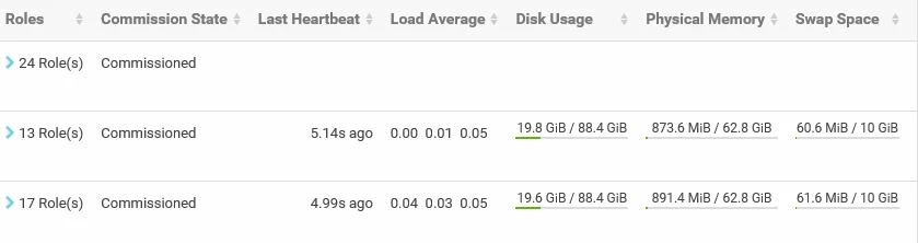

2) Where does HMON role install? On which host? If you can, send us a screenshot of the CM hosts page.
HMON is installed on VM1- screenshot below of the CM Hosts page.

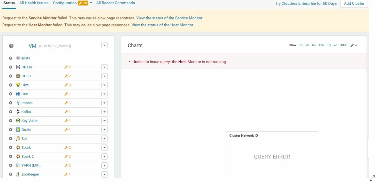

4) Is HMON showing down/stopped from CM UI? If you can, send us a screenshot of CM homepage.
HMON appears to be down. Restart attempts fail. SMON is also down and won't restart. Screenshot attached
