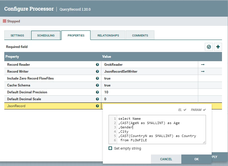

2- The easiest way I found if you dont like to use Regex is using QueryRecord with RecordReader set as GrokReader and RecordWrite set as JsonRecordSetWriter as follows
The JsonRecord is dynamic property that will define the relationship that will produce the Json output you are looking for and it has the following value:
select Name
,CAST(AgeN as SMALLINT) as Age
,Gender
,City
,CAST(CountryN as SMALLINT) as Country
from FLOWFILE

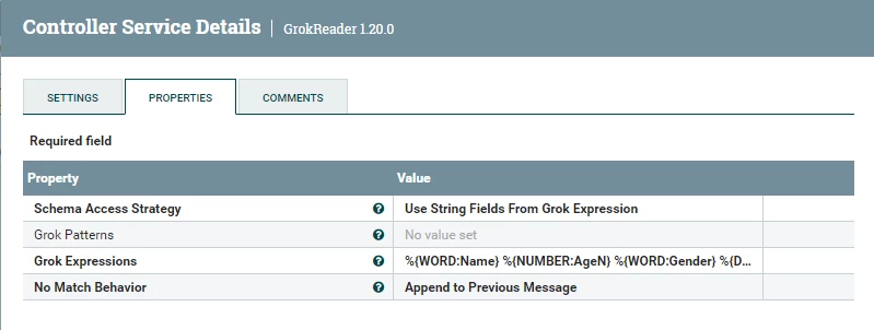

The GrokReader service is used to help you read unstructured data such as log files and its configured as the following:
The Grok Expressions Property is set to the following:
%{WORD:Name} %{NUMBER:AgeN} %{WORD:Gender} %{DATA:City} %{NUMBER:CountryN}
The Grok Expression uses predefined Regex for the given types: WORD, NUMBER, DATA...etc. For more info: https://nifi.apache.org/docs/nifi-docs/components/org.apache.nifi/nifi-reaord-serialization-services-nar/1.23.2/org.apache.nifi.grok.GrokReader/additionalDetails.html

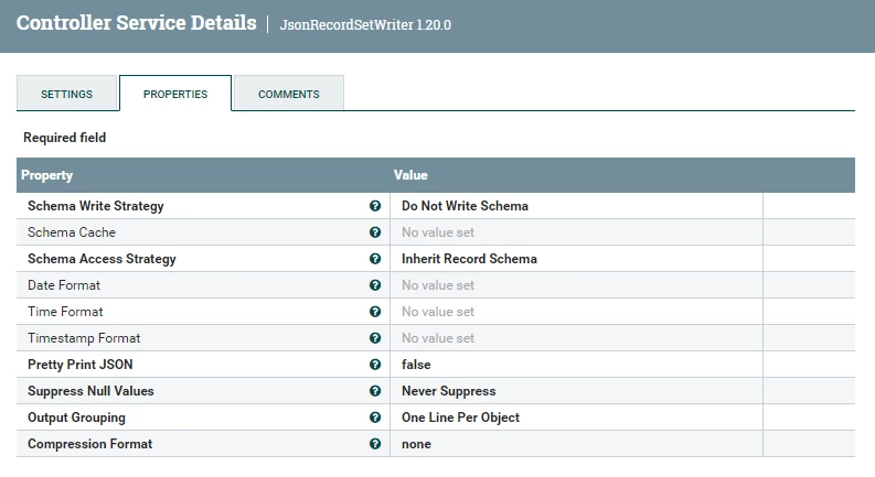

The JsonRecordSetWriter service is configured as follows :
This will produce the Json you are looking for the correct data types. Notice how I needed to still cast the Age,Country to INT despite they are being defined as Number in the Grok Expression and that is because JsonRecordSetWriter will still convert everything to string unless you provide an Avro Schema.
