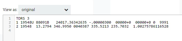

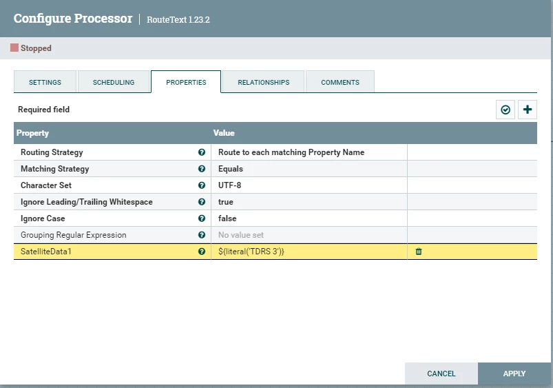

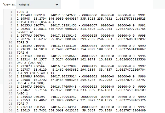

The original Dataset is a bunch of satellite data (example below).  I’m then splitting it into separate 3 line records. I then run RouteText and try and grab specific records.  For example, if I wanted TDRS 3 and AMSC 1 and SKYNET 4C, how do I pull them out with its respected 2 lines?  I tried adding a Property:  SatelliteData1 = ${literal('TDRS 3')}.  This only gives me the first line of the Split record (I need all 3).  I tried OR-Statement, but don't think I'm using it right.
${literal('TDRS 3''):or(${literal('AMSC 1')}):or(${literal('SKYNET 4C')})}
Any suggestions will be greatly appreciated.  Thanks in advance.
Original Data:
Splitting:

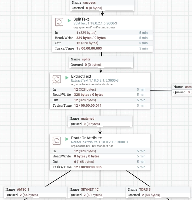

@MPHSpeed
Rather than using RouteText processor which routes individual lines of a text file, you could use RouteOnContent processor that routes the entire FlowFile whose content matches to a dynamic relationship.

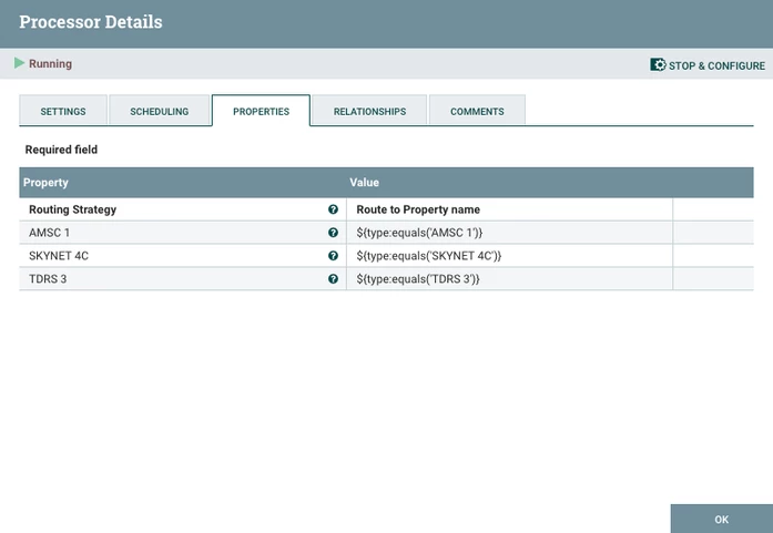

What i would do is extract the data type TDRS 3, or AMSC 1 or SKYNET 4C, etc to a FlowFile attribute using ExtractText processor and then you have that type associated with the FlowFile through your entire flow making it easy to do things like merge FlowFiles all of same type together (MergeContent with "Correlation Attribute Name"), route FlowFiles of a specific type using RouteOnAttribute, etc...
Then you also have options using the many Record based processors if you can define a schema for your data that defines your record as those three lines.
Example:
SplitText (splits relationship) ---> ExtractTEXT:
ExtractText (Matched relationship) --> RouteOnAttribute
RouteOnAttribute with above configuration will have three dynamically created relationships for the data types you want to keep.  connect each to the unique dataflow path for processing that data type.

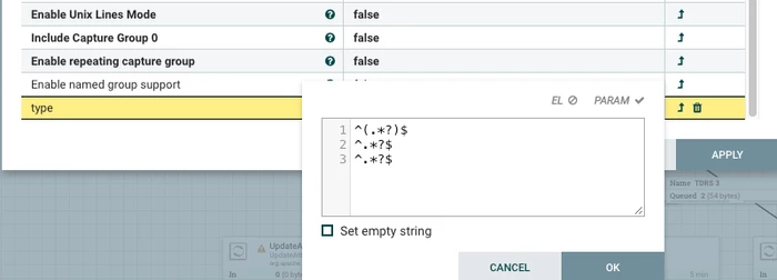

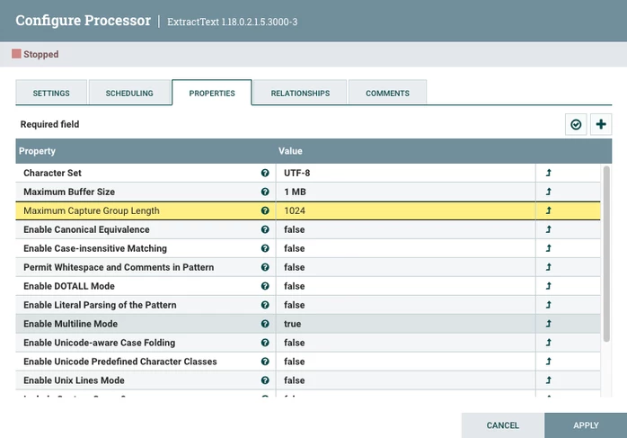

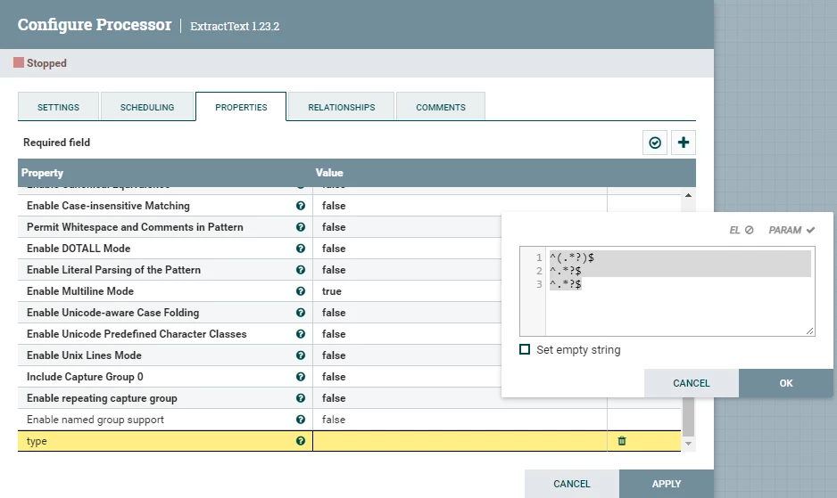

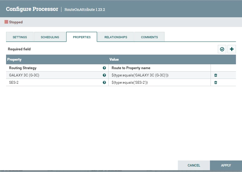

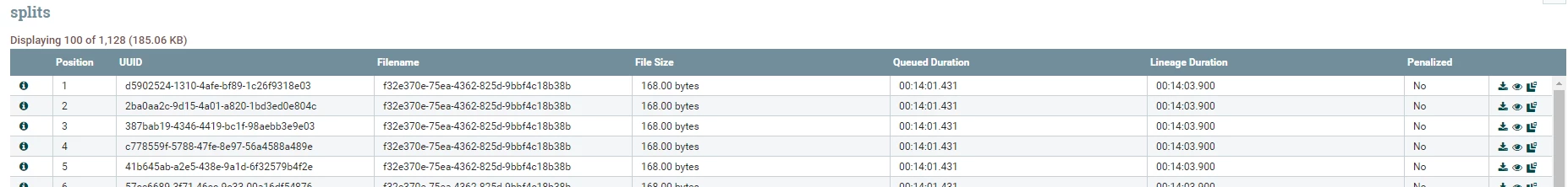

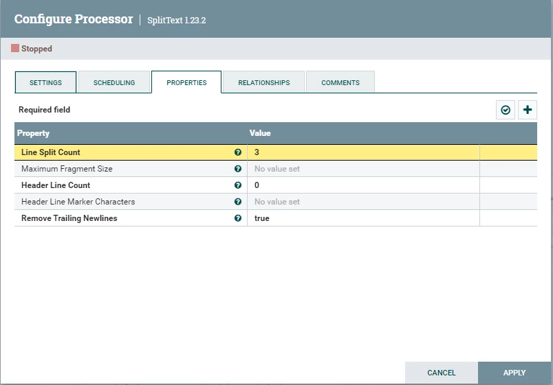

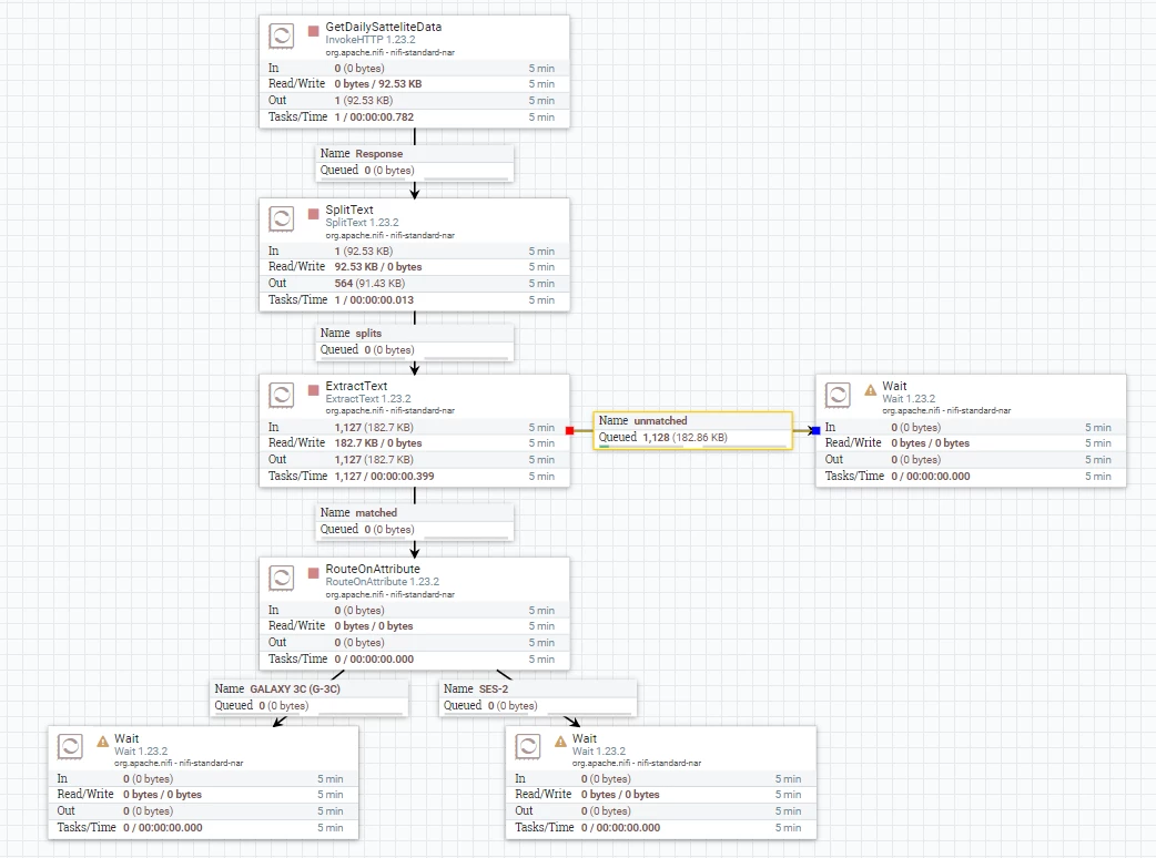

@MattWho  I get what we are doing.  It makes sense and seems to be the right way to handle it.  Unfortunately, It seems to send everything to 'unmatched' on ExtractText (at least on my end).  I made sure I had everything the same as what you provided.
I'm extracting data from here:
https://celestrak.org/NORAD/elements/gp.php?GROUP=geo&FORMAT=tle
SplitText:
ExtractText:
RouteOnAttribute:

@MPHSpeed
Working with the actual data instead of sample data I build, i would recommend making these two changes:
1. In extractText processor change "Enable Unix Lines Mode" to true.
2. In each dynamic property in RouteOnAttribute, change "equals" function to "contains" function.
