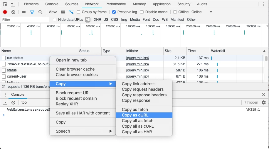

The NiFi API can be used to perform any action a user can perform directly from the UI. The best way to learn the rest-api calls is to use the "Developer tools" available via most browsers.

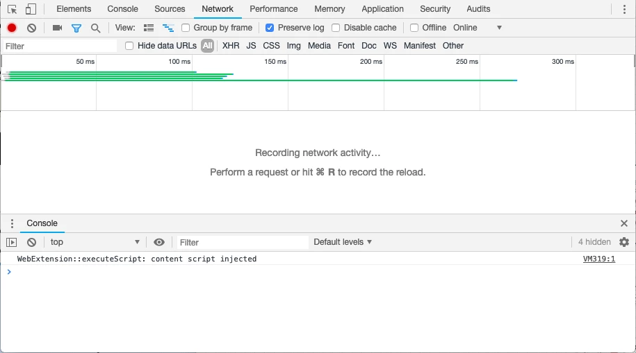

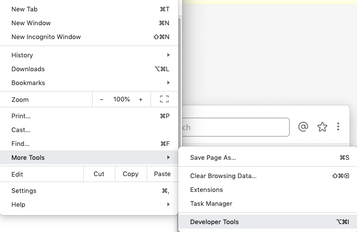

While focused on tab where NiFi UI is open, launch the developers tools.
Chrome Browser example:
Then perform the action via the NiFi UI and you will see the "Network" call display in list.
You can right click on that call and select "Copy as curl".
Now you have an example of how to execute that same request via command line.
For more info in the NIFi rest-api, you can look in "help" found within the NiFi UI Global menu (upper right corner). The Rest Api documentation can be found in the "Developer" section at bottom of list on far left side of help UI.
The danger with trying to "run" dataflows in NiFi via command line is you may end up stopping processors in the dataflow chain that results in FlowFile being unprocessed and sitting on connection queues between processors.

NiFi processors are configurable to run using a Timer Driven or Cron Driven scheduling strategy. This scheduling can uniquely configured per each processors configuration. Processors are then started and the operate based on the configured scheduler from that point forward.
