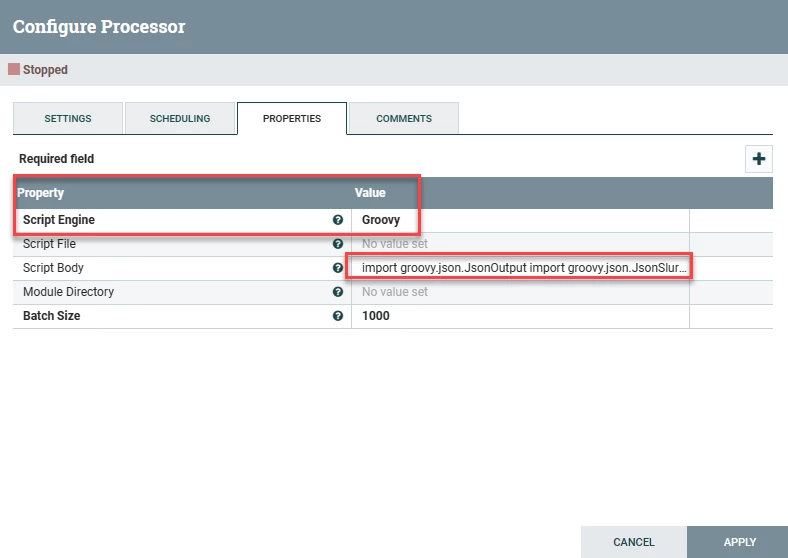

I would do this with a Groovy based InvokeScriptedProcessor
Using this code:

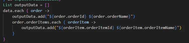

List outputData = []
data.each { order ->
outputData.add("${order.orderId} ${order.orderName}")
order.orderItems.each { orderItem ->
outputData.add("${orderItem.orderItemId} ${orderItem.orderItemName}")

processor = new GroovyProcessor()
Don't let all that code scare you when the part that's doing the formatting is only these lines:
This is the generated output:
