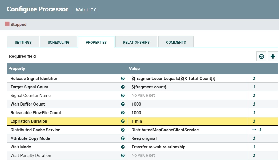

How to apply wait processor for capture complete records before merger them
I have a scenario where am triggering API in batches (1000 records in each). from the first API I get the value of total records in attribute list X-Total-Count, i wants to merge them all. Please let me know how i can leverage the wait processor in it to wait until we get the whole data till value of X-Total-Count.
Wait Processor properties, i have configured.

Before merge the whole data, i want "Wait" processor for waiting the completion of API (api could be run 2 times or 15times) after getting the whole data that "FlowFile" (fragment.count) is equals to "X-Total-Count" i.e ${fragment.count:equals(${X-Total-Count})}. then it notify to pass all data "MergerRecord" and a single FlowFile would generates.

2. You have configured the "Release Signal Identifier" with a boolean NiFi Expression Language (NEL) that using your example will return "false" until "fragment.count" FlowFile attribute value equals the FlowFile attribute "X-Total-Count" value.
        2a. I assume you are writing "X-Total-Count" to every FlowFile coming out of the SplitJson?  How are incrementing the "fragment.count" across all FlowFile in the complete 5600 record batch.  Each FlowFile that splits into 1000 FlowFiles via splitJson will have fragment.count set to 1 - 1000.  So fragment.count would never reach 5600 unless you are handling this count somewhere else in your dataflow.
        2b. If a FlowFile where value from "fragment.count" actually equals value from "X-Total-Count" attribute, your "Release Signal Identifier" will resolve to "true".  The ""Release Signal Identifier" value (true or false) in your configuration is looked up in the configured "distributed map cache server.  So where in your dataflow to you write the release signal to the distributed map cache? (usually handled by a notify processor)
