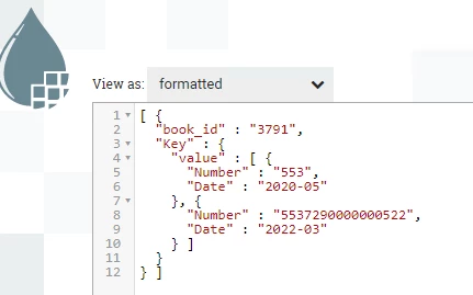

how to convert a date from below JSON file from mm/yy to yyyy-mm format using NIFI
Need help  to convert a date from below JSON file from mm/yy to yyyy-mm format using NIFI
    "book_id": "3791"
    "Key": {
        "value": [
                "Number": "553",
                "Date": "05/20"
                "Number": "5537290000000522",
                "Date": "03/22"

How I would do this:
- Create an UpdateRecord Processor, where I define a JsonTreeReader, for reading the input file and a JsonRecordSetWriter, for writing the newly formatted file.
- Within this same processor, I would add a new property where I define the path to the column you are trying to modify. In your case, assuming that this is the entire JSON File, you would have /Key/value[*]/Date.
- The value for this newly generated property should be the transformation you are trying to achieve. In your case, it would be ${field.value:toDate("MM/yy"):format("yyyy-MM")}
- Next, within the same exact processor, I would modify the Replacement Value Strategy from the default value into Literal Value.
And that's pretty much all you have to do.

Hello , Thankyou for your reply.
In my local NIFI when I created the updateRecord processor, it suppported-  UpdateRecord 1.21.0
with which I was able to transform successfully.
But In the Sandbox environment When I created the updateRecord processor, it supported-  UpdateRecord 1.18.0.2.1.5.1005-1
with which I am getting below error.
UpdateRecord[id=bbde4766-0009-18f4-0000-00000eaf934b] Failed to process FlowFile[filename=32534d2a-ebfb-4e98-84a8-fdf5c865989f]; will route to failure: java.lang.IllegalStateException: Null String illegal for SerializedString
I have verified the Input Json in both local as well as the Sandbox and are same
But getting the above error in Sandbox Env.
Could you please help me on this?
