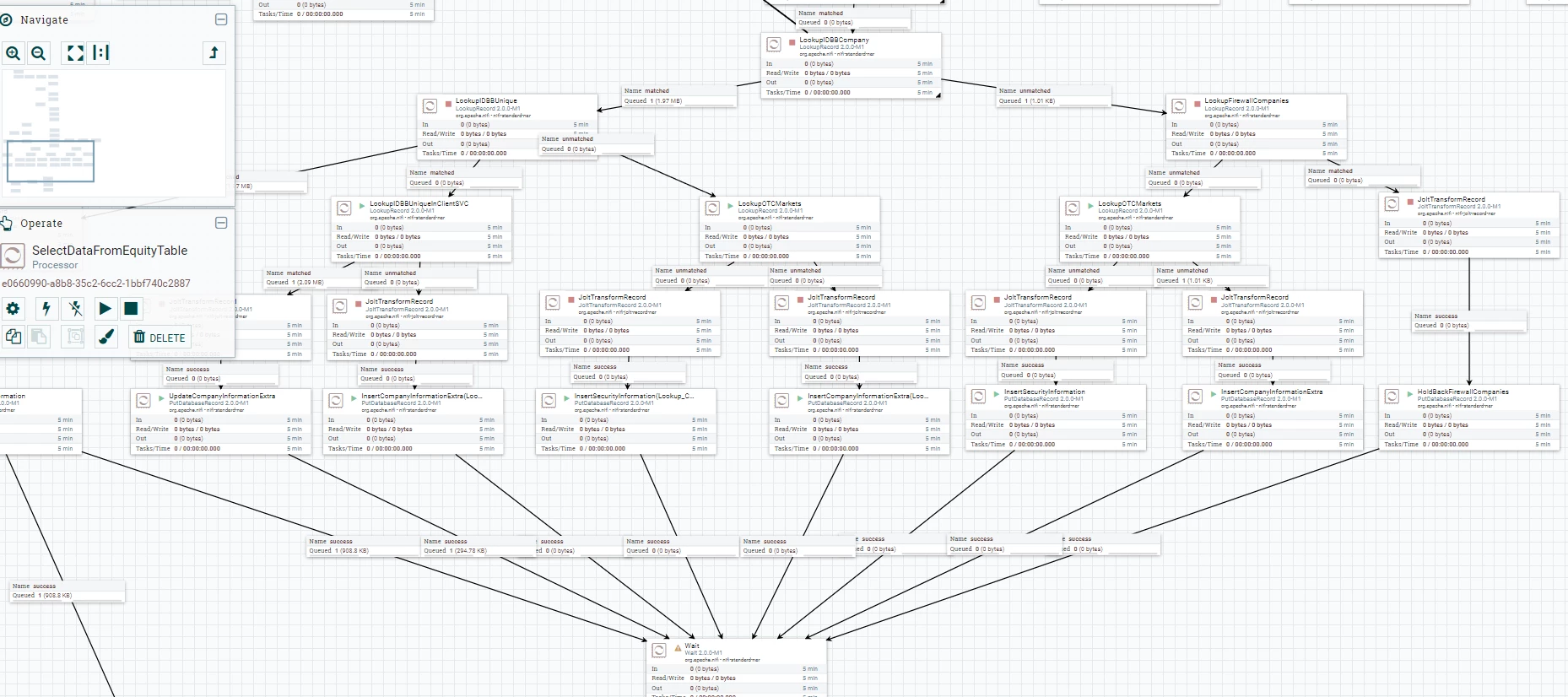

Hi! I'm using NiFi 2.0.0 M1, and I'm writing a flow inside a processed group. I had a problem when I wrote the flow.
The flow should be run as an individual task. Every time when it is run, it will take in some data from a table on MySQL Server, use many LookupRecord Processors and then process the matched and unmatched data respectively. Finally, it turns out to have 9 branches within the flow.
After processing all these, I need to trigger an ExecuteSQLRecord processor which will call some stored procedures in MySQL. Literally, only when all the above branches finish running should this processor be triggered (and it should be triggered only once in one task). To achieve this, I wanted to use Notify and Wait processor to detect whether all the branches finish running and when I should trigger the ExecuteSQLRecord processor. However, I can only set a fixed number of signals to wait for in the Wait processor, while in the real case, sometimes not all of the 9 branches will be run. (Because, sometimes, there won't be matched or unmatched data for a lookup processor, and hence the corresponding branch won't be triggered to run.)
Did anyone face the same problem as mine? Is there any good way to achieve my goal?
(Below is part of the flow. You can see that I tried to use Wait but was kind of stuck there 😭)

This might be a good use case for using the FlowFile Concurrency  and Outbound Policy configuration option on a process group.  FlowFile concurrency allows you to place a portion of your dataflow into a process group and be able to control how the initial FlowFile or batch of FlowFiles is allowed to enter that process group for processing.  The Outbound Policy controls when the FlowFiles being processed in that process group will be released to processor(s) downstream of that process group.  Downstream components of the process group will not receive FlowFiles from the process group until all FlowFiles within the process group have either been auto-terminated or queued up to one or more output ports.  When the outbound policy is met, the FlowFile(s) are released downstream and the Process group's FlowFile concurrency then allows for next batch processing.  So it might makes sense to place the portion of your dataflow comprised of your nine concurrent branches in this bounded process group and downstream you have your your ExecuteSQLRecord processor call your final procedure now that you know all branches have completed.
Above solves your problem with not all nine branches always being used.

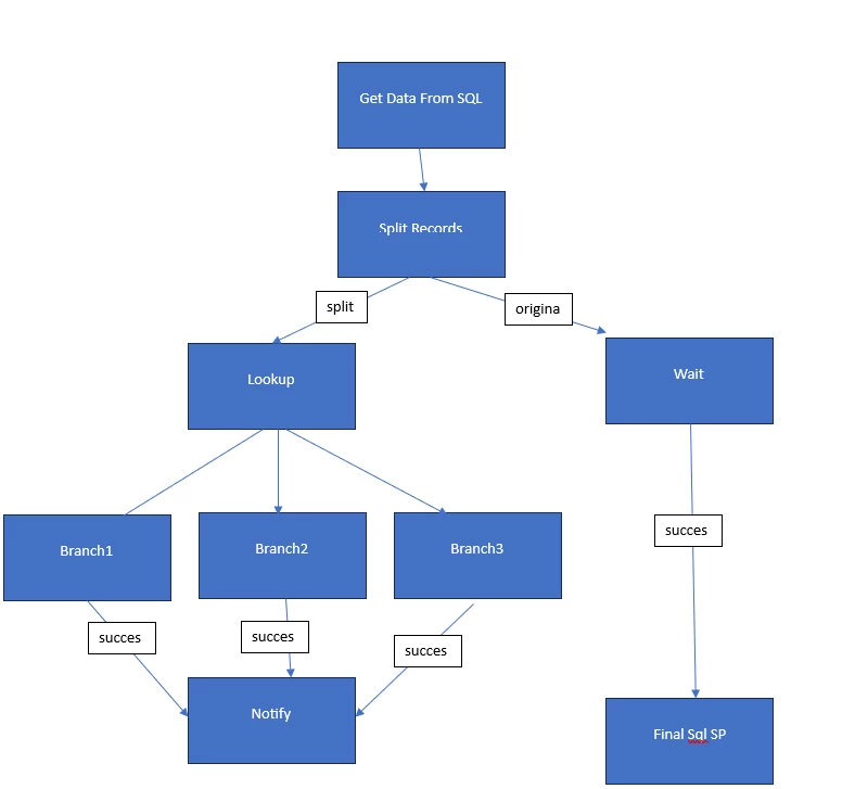

Hi @iriszhuhao ,
The wait processor is supposed to be used with the Notify processor to work correctly and its more suited for when  you have a data that will be split downstream  where each split flowfile will have a common identifier and split count that the Wait-Notify processors can go by  as explained in this article:
https://pierrevillard.com/2018/06/27/nifi-workflow-monitoring-wait-notify-pattern-with-split-and-merge/
When you get the data from SQL do you get it all in one flowfile or its already split where each record in one flowfile. If you are not getting a lot of data then I would recommend to get it all in one flowfile and then split it so that you can use this pattern and to run the final SP once. So the design will look something like this:
In this case the Wait-Notify Signal identifier will be the value of the fragment.identifier and the Wait Target Signal Count will be the value of the fragment.count which both written by the Split processor.
If you find this helpful please accept solution.
