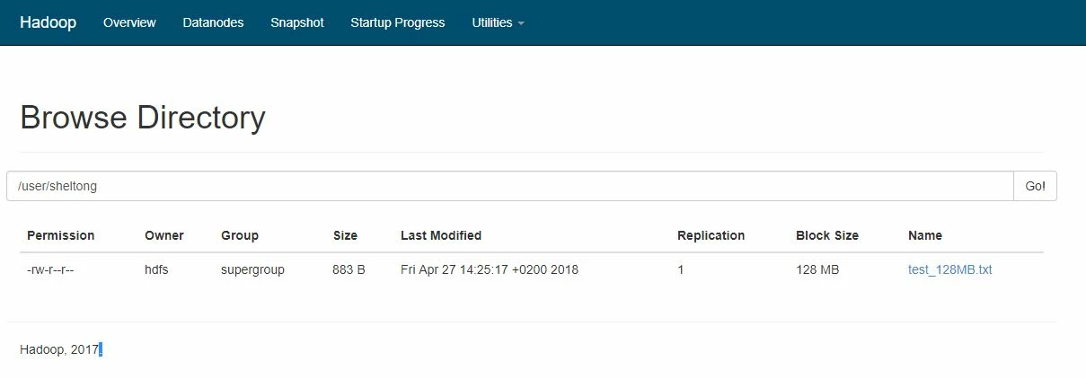

Created a file test_128MB.txt
$ vi test_128MB.txt
Uploaded a 128 MB files to HDFS
$ hdfs dfs -put test_128MB.txt /user/sheltong
see attached screenshot 128MB.JPG notice the block size

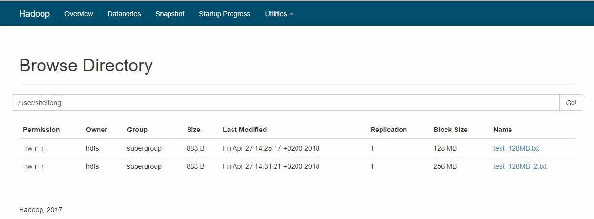

I then copied the same file back to the local filesystem,
$ hdfs dfs -get /user/sheltong/test_128MB.txt /tmp/test_128MB_2.txt
The using the -D option to define a new blocksize of 256 MB
$ hdfs dfs -D dfs.blocksize=268435456 -put test_128MB_2.txt /user/sheltong
See screenshot 256MB.JPG, technically its possible if you have a few files but you should remember the test_128MB.txt and test_128MB_2.txt are the same files of 128MB, so changing the blocksize of an existing files with try to fit a 128bock in a 256 MB block leading to wastage of space of the other 128MB, hence the reason it will ONLY apply to new files.
$ vi test_128MB.txt
