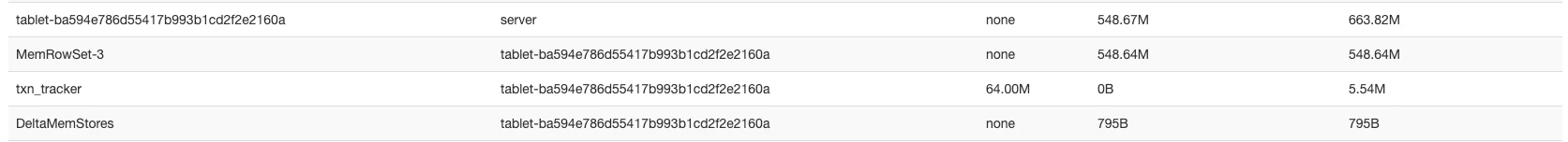

We are testing heavy write on kudu-1.8 shipped by CDH 6.1.1. Now we have around 350 "hot replicas" on one t-server. When we are ingesting the data, the memory consumed by each tablet keep on increasing and eventally the total used memory end up being exceeding the memory limit we give to kudu.
From the mem-tracker, some replica's memrowset use as much as 500 MB,does that mean we need to provide up to 350 * 500 MB= 175 GB for each t-server?  Is there any way/config to limit/throttle the memory consumed by memrowset(The limit shows in mem-tradcker UI is "none", see below screenshot)? Any suggestion will be appreaciated, thanks!

As the a tserver approaches the memory limit, it'll apply backpressure on incoming writes, forcing them to slow down. This backpressure (and the limiting mechanism in general) is process-wide; there's no way to customize it for a particular tablet or memrowset.
If you let your write job run for a while, the memory usage should eventually stabilize. If it doesn't, please share a heap sample as per the instructions found here.

Thanks for reply Adar! It seems there is no backpressure you mentioned take place before it hits the memory limit (Service unavailable: Soft memory limit exceeded). Then it starts to reject incoming writes which bring down the ingestion rate a lot, that is not the backpressure you mentioned right?
I will try to paste a heap sample here.

Besides the limit itself, there are two additional knobs you can experiment with: --memory_limit_soft_percentage (defaults to 80%) and --memory_pressure_percentage (defaults to 60%).
