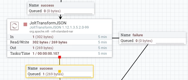

@Wisdomstar
You should be able to use the JoltTransformJson NiFi processor to accomplish this.
There is a thread here where a jolt specification example exists fro doing what you are trying to do:
https://stackoverflow.com/questions/54696540/jolt-transformation-lowercase-all-keys
Add the Jolt specification in to the "Jolt Specification" property in the JoltTransformJson NiFi processor.  Set "Pretty Print" to true if you still want the nice multi-line formatted json to be produced.
