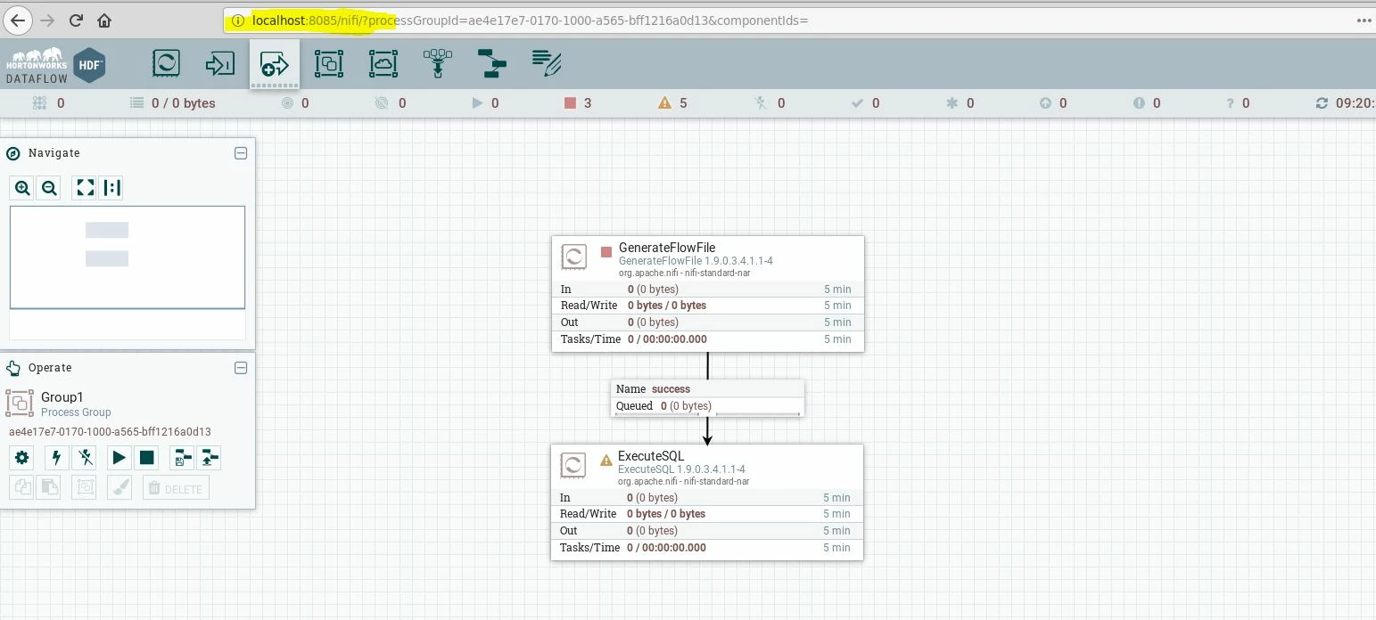

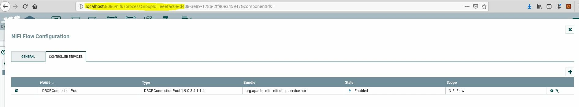

I have created a sample controller service and mapped to a processor in source.
Source:

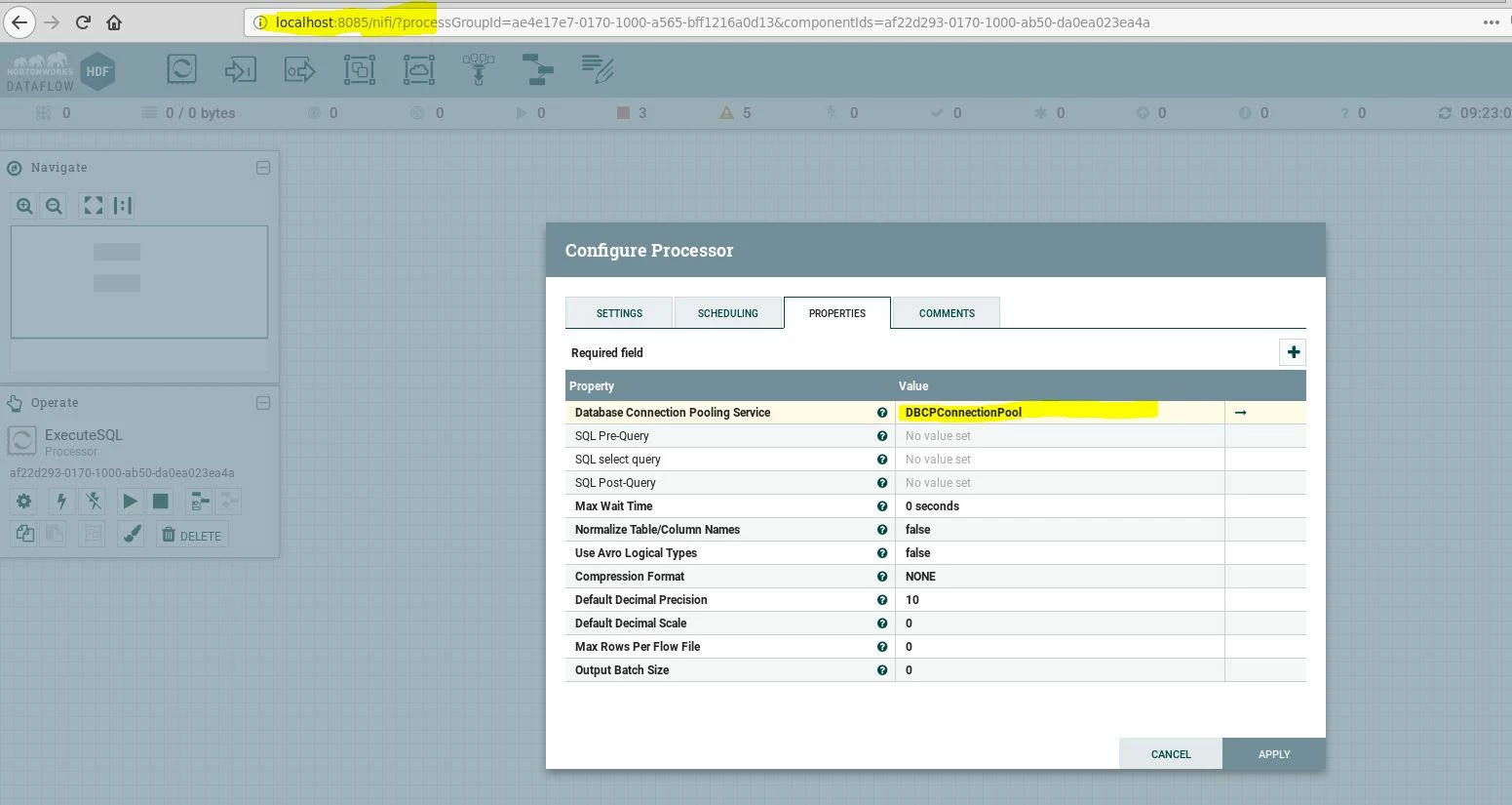

created a process group and execute sql processor and assigned created controller service to "Execute SQL" processor
Executesql before map.JPGMapped controller serviceMapped controller service

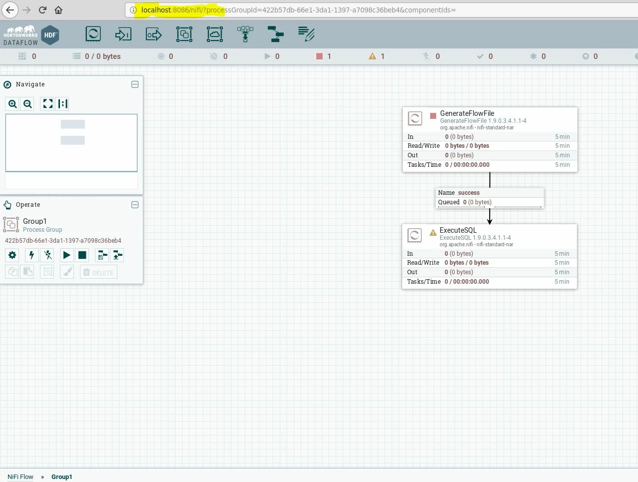

Destination:
Created a new instance with different port 8086 and manually exported and imported Process group by creating a template.
Now my Destination instance looks similar to Source instance without any controller services.
Destination without controller serviceDestination without controller service

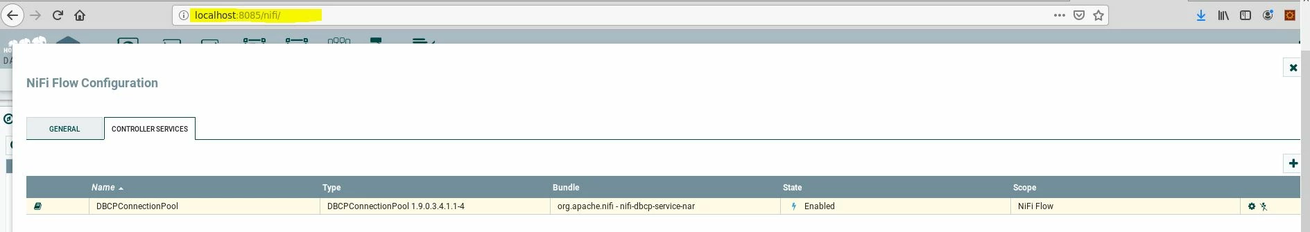

Now I am able to Import/create controller service from external location by using
"PGCreateControllerService".
After importing to destinationAfter importing to destination
Now i am looking how to map the controller service with Processor using Toolkit or any is there any other way to achieve.
