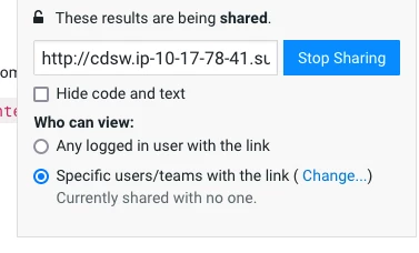

Hi.
When you go to share a session, there is a box to "Hide code and text" - does this work for you?
I don't really see a way to do this inside of a scheduled job. I think your best bet is to write whatever important data that you want to share to a file, and then when you set up your job, uncheck the button to share the console and include the attachment. Can you try that?
