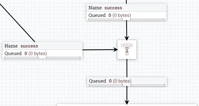

There is no way to click on an existing connection with queued data and select/copy the queued FlowFiles from that connection to another connection.
If you want to join to different connections together, you can use a "funnel". With the processors on both ends of a connection stopped, you will be able to click on that connection and drag the small blue square at destination side of connection to another end-point. This will cause any connections feeding into the funnel to be funneled into a common destination queue.

thanks. works perfectly
