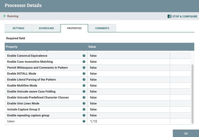

The ExtractText can be used to extract the token from the response written to the FlowFiles content and added as an attribute on the FlowFile before next invokeHTTP processor.  Since I do not know much about Sharepoint or the format of the responses received, I can only give an example based on a returned token from NiFi's rest-api:
The entire response body would be placed in a FlowFile attribute named "token".

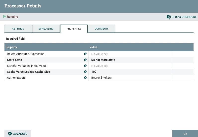

In the case of the NiFi token, I must then build a proper "Authorization" header with that token before being able to make additional rest-api calls using it.  To do that, you can use an UpdateAttribute processor:
So here I added "Bearer " to the token and write it to a new FlowFile attribute "Authorization"; although, you could also simply update the existing "token" attribute instead.
Then in the next InvokeHTTP processor you can pass this "Authorization" FlowFile attribute value in a header by adding a dynamic property:

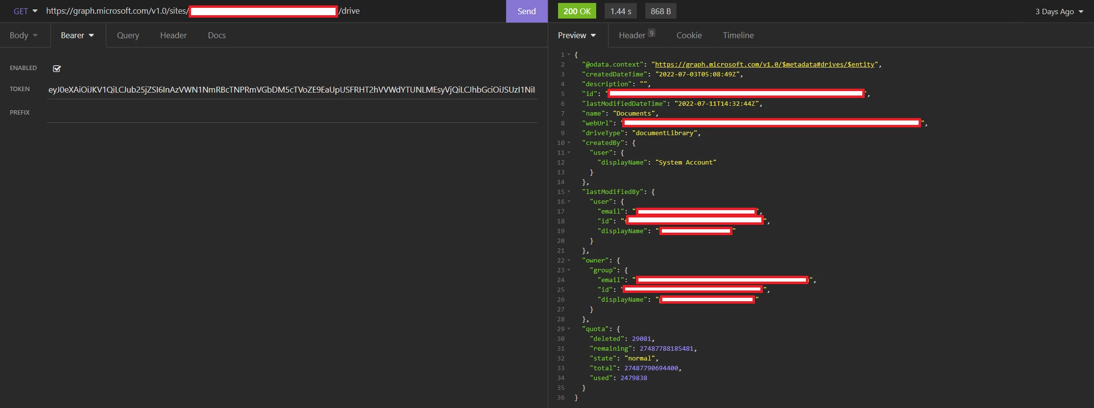

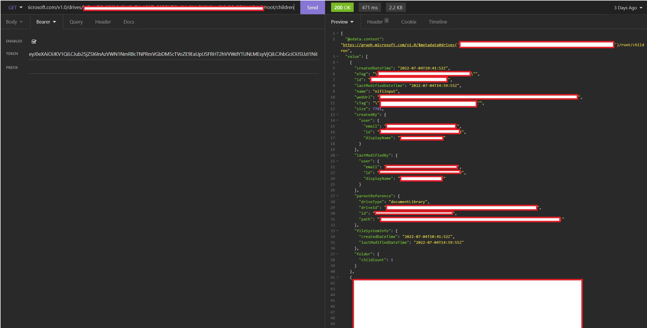

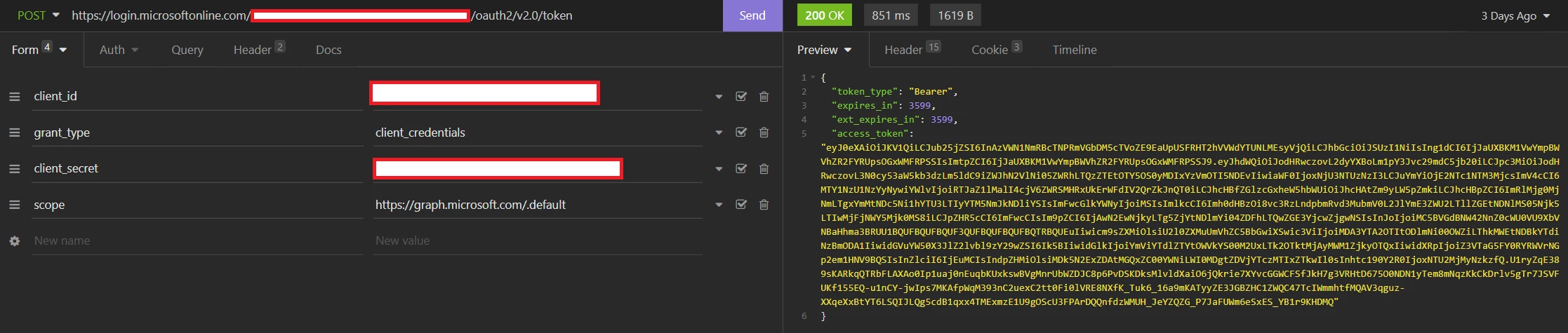

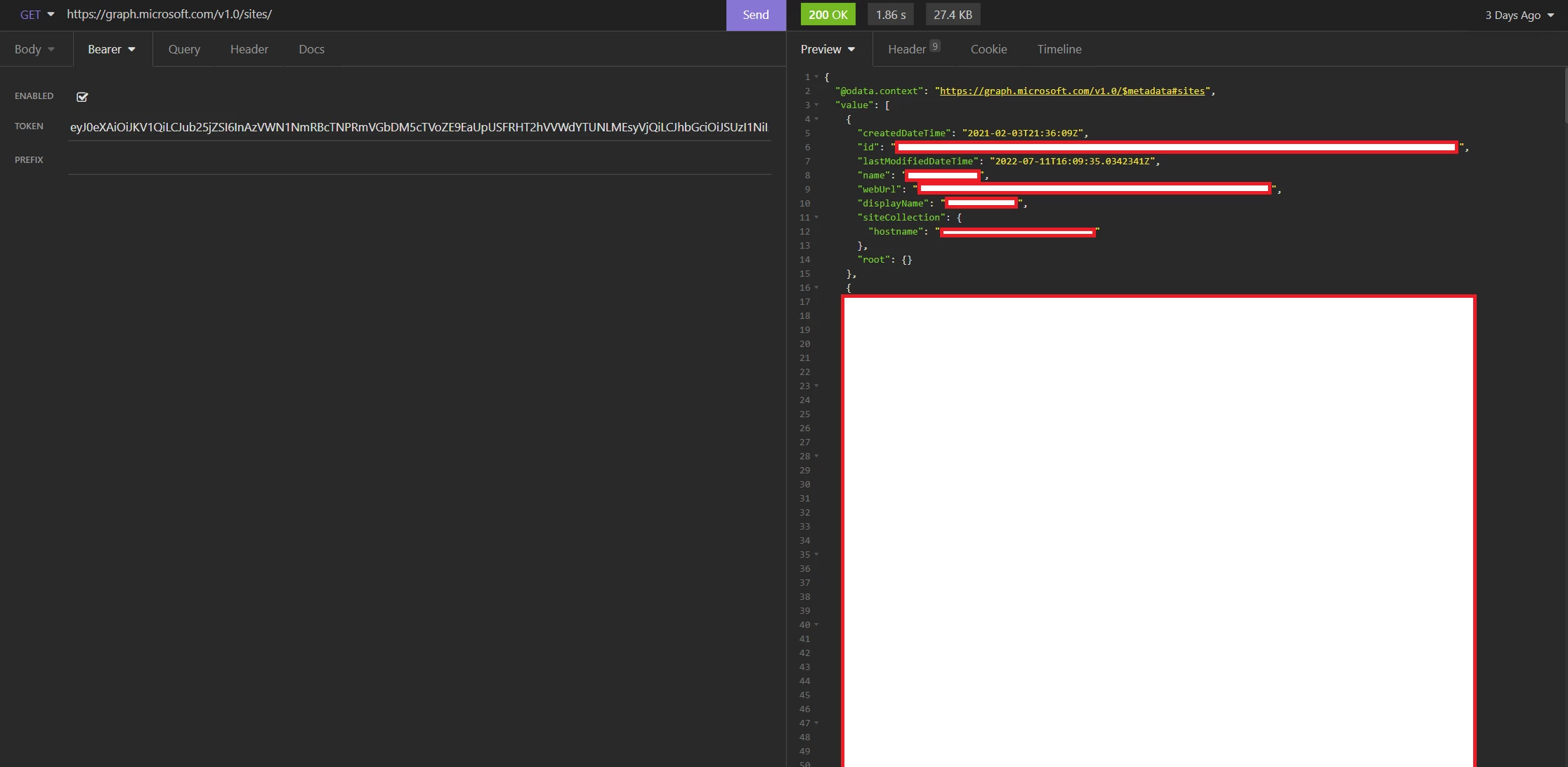

@MattWho Below are the screenshots of the APIs and their structure.

so this looks doable as I described above.  Not sure what program you are using in your screenshots as it does not show the full rest-api call structure.
