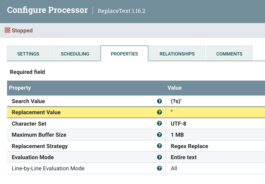

@baymax277 ,
The problem with your file is not the square brackets ([ ]). The issue is that single quotes are not a valid JSON quote. The correct JSON would be:
{"a":1,"b":2},
{"a":3,"b":4}
The content above is processed correctly by NiFi if you use record-based processors (like, for example QueryRecord).
Ideally your source data should be fixed to provide a valid JSON. For example, if those files are being generated by a Python script like this:
my_object = [{'a': 1, 'b': 2}, {'a': 3, 'b': 4}]
print(my_object)
The Python script should be updated to do this instead:
import json
print(json.dumps(my_object))
If you cannot have the source data fixed, you can try to replace the single quotes with double quotes using a ReplaceText processor with the following configuration.
This is a simplistic approach, though, and can cause problems in some complex JSON objects if you have strings with unexpected sequences of characters in them.

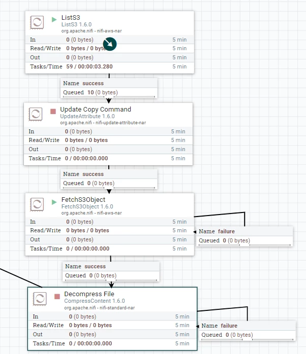

@araujo
The jsons files are compressed and are placed in an S3 bucket. Here's the flow I have created to fetch s3 file and decompress it.
Translate

@baymax277 ,
Could you also share the screenshot of the part of the flow where the error is happening? I think that's after the Decompress File step, right?
