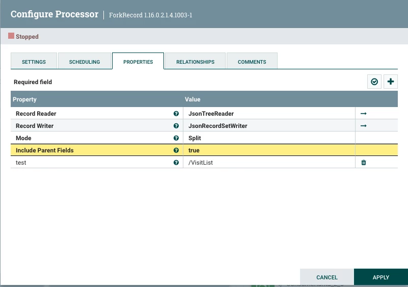

@Dracile - Instead I recommend using ForkRecord Processor.
Like @steven-matison mentioned, create a Record Reader and Record Writer and add another property with the record path /VisitList, Mode - Split, Include Parent Fields to True.
This will result in the next flowfile looking like this -
"employer" : "98765",
"loc_id" : "312",
"topId" : "Management",
"VisitList" : [ {
"S1" : "HR",
"S2" : "Accountant"
"loc_id" : "312",
"VisitList" : [ {
"S1" : "Manager",
"S2" : "Sr. Manager"
Then you could split on $ using a SplitJson processor or even better continue using more record-oriented processors for better  performance 🙂
