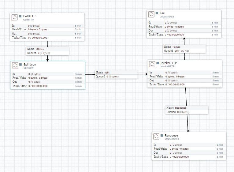

Im trying to do an app that takes a json from a web filter the url attribute of the JSON and get the html of this url.
My problem is that I can’t set in the property remote url in InvokeHTTP the url that I got in SplitJSON.

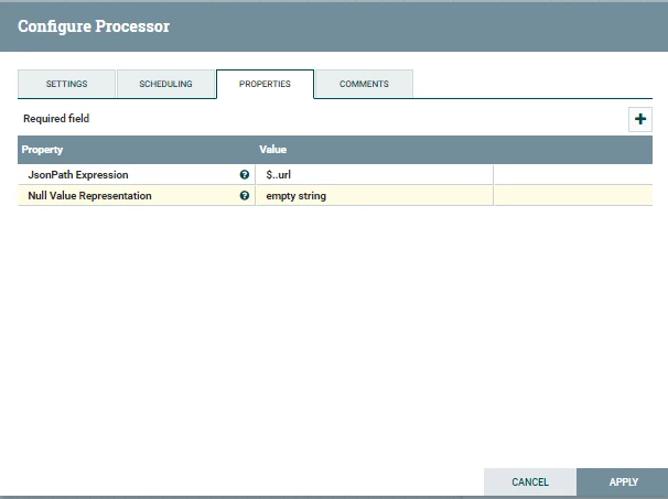

This is the config of splitJSON (it works, the output is the url that i want)

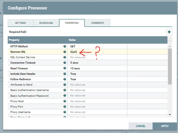

And this is the conf of the InvokeHTTP (it work if I set manually the url) but I dont know how to set a dinamic url.

@Lucas Alvarez
The SplitJSON processor splits an incoming JSON on to multiple output JSON messages. You should use the EvaluateJSONPath processor to extract the URL from your splits and ssign them to a FlowFIle attribute you acn then use in your InvokeHTTP processor.
