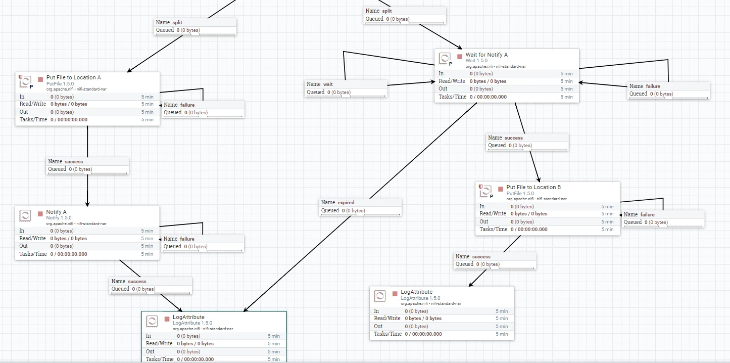

HI,
I would like to create data flow,which put file to one directory, and the if it has succeded, put the same file to another directory

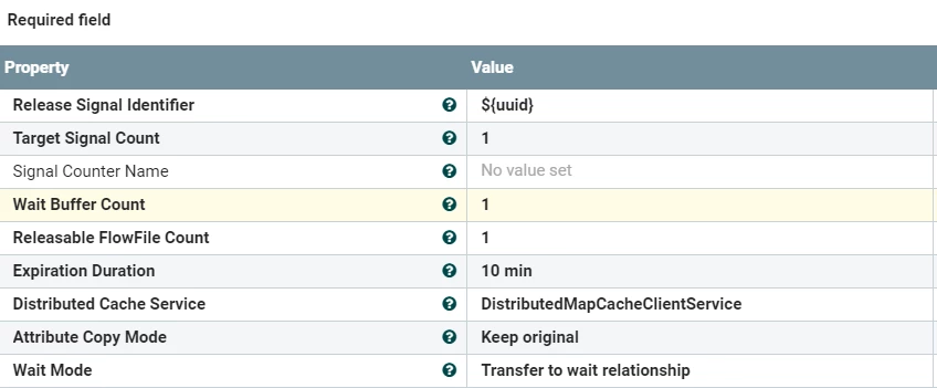

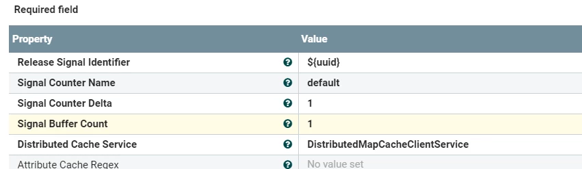

I use for that Notify/Wait, but I wonder if uuid is a good solution for the signal,
Are Wait/Notify properties adequate ?
or if there is another way ?

ok you are right, for this kind of flow
but when I have for example:
- one flow for data acquisition from source to Cassandra in one process group
- second flow for data ingestion from Cassandra in another process group
How to set properties in Wait/Notify in this kind of flow ?
Unless there is also possible another solution ..
