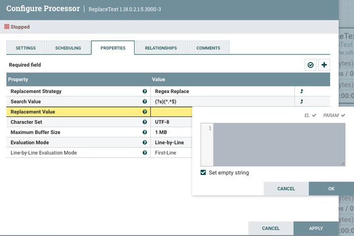

Say I have a file having 100 records. In this file I want to ignore the first line as it's data I do not want to process (It contains some info like file name, date and number of records). I want to process from second line. How to do that?

A NiFi FlowFile is what is passed from one processor component to the next.  There is no direct relationship between what processing was done in one processor versus another.  Each Processor will read the FlowFile (consists of FlowFile Attributes/metadata and FlowFile content) and execute its processor code against the FlowFile and output a FlowFile(s) to one or more outbound relationships.  So processing against the content of A FlowFile becomes the responsibility of each processor separately.   So the questions asked correlate to the answer you'll get.
With what you shared, I can only suggest that you remove the first line from the content of the FlowFile so that downstream processor will only have line 2 to process against.
This can be accomplished easily with a ReplaceText processor.  Simply configure it for  "Evaluation Mode" = "line-by-line", "line-by-line Evaluation Mode" = "First-Line", and in "Replacement Value" property "Set empty string" check box.
The output FlowFile' content, which is sent to the success relationship, will have everything except its first line.
 Do you need to preserve line 1?
If so, maybe use ExtractText to extract line 1 to a FlowFile attribute you can then use after processing to add back to Content again using ReplaceText.
