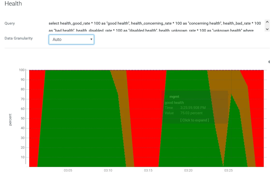

I do anything, and after the upgrade, I found the cloudera-scm-agent is not stable.
