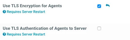

@Roroka,
We need to make sure that your Cloudera Manager configuration matches with the agent configuration.
Based on the below configuration, your agent is configured to use TLS but will perfom no validation of the Cloudera Manager certificate.
In order for a heartbeat to work, then, you would need to have this configured in Cloudera Manager:
You will also need to have configured Cloudera Manager to listen via TLS.
The 'sslv3 alert bad certificate' message indicates that CM did not receive the certificate it expected from the agent (for authentication).  I believe this indicates you have Use TLS Authentication of Agents to Server enabled in CM so CM expects agents will present a certificate.
If you are just installing, though, I would not expect TLS to be involved at all.  Did you enable "Auto-TLS" during installation.  If so, do you have Cloudera Express?
We need more of an understanding of the steps you used to install and also the current configuration of CM.  Also, we need to know what your goal is at this stage and if you were trying to enable TLS in some way...
Thanks!

[17/Jul/2019 14:24:17 +0000] 8512 MainThread agent INFO Failed to read available parcel file: [Errno 2] No such file or directory: '/var/lib/cloudera-scm-agent/active_parcels.json'
[17/Jul/2019 14:24:17 +0000] 8512 MainThread agent ERROR Heartbeating to cm.example.com:7182 failed.
Traceback (most recent call last):
File "/opt/cloudera/cm-agent/lib/python2.7/site-packages/cmf/agent.py", line 1387, in _send_heartbeat
self.cfg.max_cert_depth)
File "/opt/cloudera/cm-agent/lib/python2.7/site-packages/cmf/https.py", line 139, in __init__
self.conn.connect()
File "/opt/cloudera/cm-agent/lib/python2.7/site-packages/M2Crypto/httpslib.py", line 69, in connect
sock.connect((self.host, self.port))
File "/opt/cloudera/cm-agent/lib/python2.7/site-packages/M2Crypto/SSL/Connection.py", line 309, in connect
ret = self.connect_ssl()
File "/opt/cloudera/cm-agent/lib/python2.7/site-packages/M2Crypto/SSL/Connection.py", line 295, in connect_ssl
return m2.ssl_connect(self.ssl, self._timeout)
SSLError: sslv3 alert bad certificate
[17/Jul/2019 14:24:17 +0000] 8512 MainThread heartbeat_tracker INFO HB stats (seconds): num:1 LIFE_MIN:0.01 min:0.01 mean:0.01 max:0.01 LIFE_MAX:0.01
And below is the output when I enter "grep -v -e '^[[:space:]]*$' -e '^#' /etc/cloudera-scm-agent/config.ini"
[General]
server_host=cm.example.com
server_port=7182
max_collection_wait_seconds=10.0
metrics_url_timeout_seconds=30.0
task_metrics_timeout_seconds=5.0
monitored_nodev_filesystem_types=nfs,nfs4,tmpfs
local_filesystem_whitelist=ext2,ext3,ext4,xfs
impala_profile_bundle_max_bytes=1073741824
stacks_log_bundle_max_bytes=1073741824
stacks_log_max_uncompressed_file_size_bytes=5242880
orphan_process_dir_staleness_threshold=5184000
orphan_process_dir_refresh_interval=3600
scm_debug=INFO
dns_resolution_collection_interval_seconds=60
dns_resolution_collection_timeout_seconds=30
[Security]
use_tls=0
max_cert_depth=9
[Hadoop]
[Cloudera]
[JDBC]
[Cgroup_Paths]
Thanks!

Hi @bgooley,
I've changed some settings, the error about "heartbeat"still
MainThread agent ERROR Heartbeating to cfchadoopuat02.clg01.chailease.com.tw:7182 failed.
self.conn.connect()
And the output when I enter "grep -v -e '^[[:space:]]*$' -e '^#' /etc/cloudera-scm-agent/config.ini":
[General]
server_host=cfchadoopuat02.clg01.chailease.com.tw
server_port=7182
scm_debug=INFO
[Security]
use_tls=1
max_cert_depth=9
[Hadoop]
[Cloudera]
[JDBC]
[Cgroup_Paths]
Thanks.
