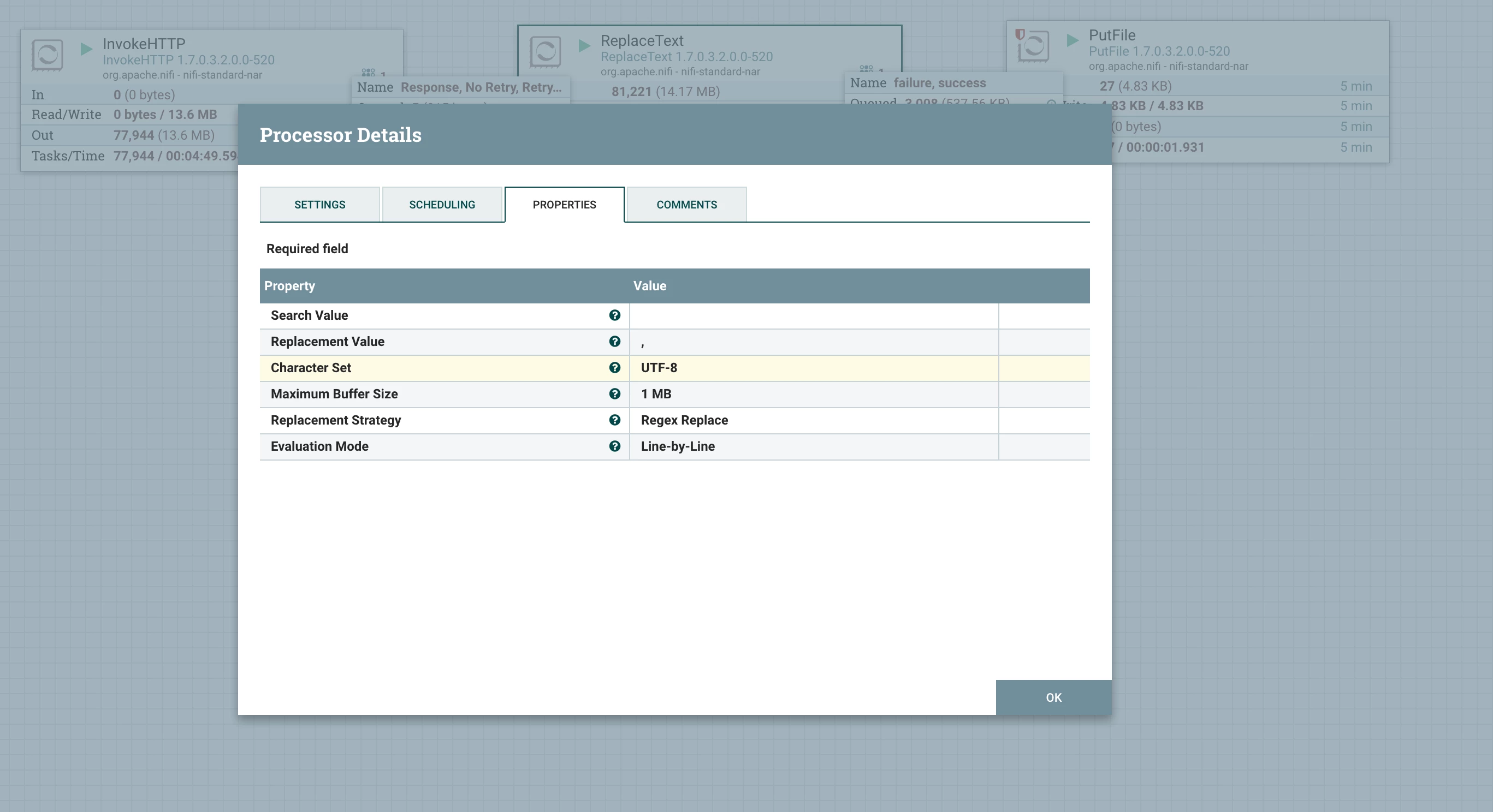

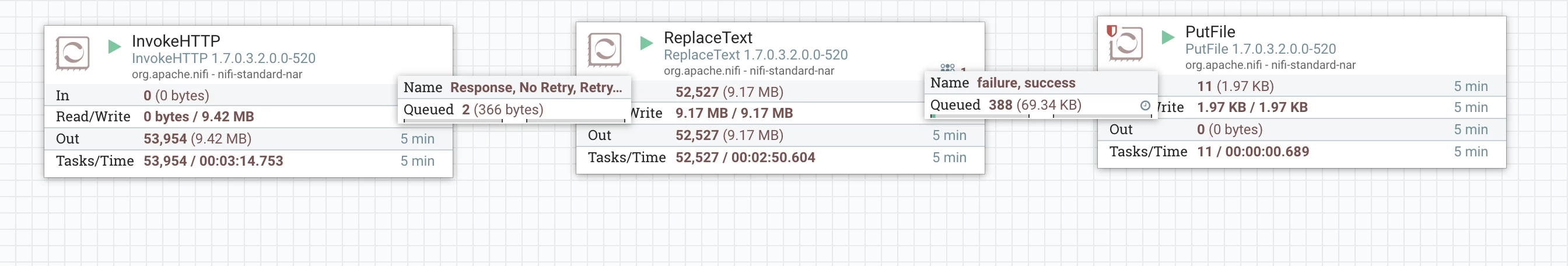

May be you can use the "InvokeHTTP" --> "ReplaceText" --> "PutFile" processors like following:
Here in "ReplaceText" processor can be used something like following to replace Search Value = TAB with COMMA
ReplaceText Properties:
Search Value =
Replacement Value = ,
Character Set = UTF-8
Maximum Buffer Size = 1 MB
Replacement Strategy = Regex Replace
Evaluation Mode =  Line-by-Line
And then it should be able to replace the TABs with Comma.

@Jay Kumar SenSharma Thank you very much! It helped
