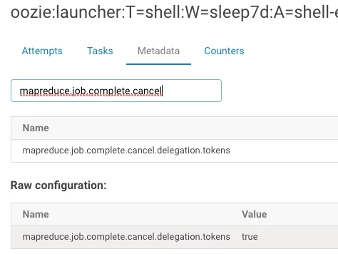

Please explain why we need to set 'mapreduce.job.complete.cancel.delegation.tokens' to 'TRUE' in our case.
We confirmed the workflow we tested previously.
We didn't set this, but it will be retrieved as 'TRUE' in the job's metadata in HUE.
It seems to be the default value, do I have to set it as a property in the workflow as you said?

Sep 16, 2022 10:16 AM UTC
Hi,
Below is the suspected causes for this issue:
https://issues.apache.org/jira/browse/YARN-3055
https://issues.apache.org/jira/browse/YARN-2964
Yes, You can set that parameter at workflow level and test.

I'm checking the YARN-2694 and YARN-3055 patches. It's like a patch for a bug where the token is revoked when an app in the workflow completes, and other apps don't renew the token.
I still don't understand how this bug relates to setting the mapreduce.job.complete.cancel.delegation.tokens setting to true.
Could you please explain the behavior you expect when you set mapreduce.job.complete.cancel.delegation.tokens to true?
Shouldn't the token be prevented from being canceled by setting the mapreduce.job.complete.cancel.delegation.tokens setting to false ?

Sep 29, 2022 2:45 PM UTC
@ChethanYM
I have dfs.namenode.delegation.token.max-lifetime in YARN(yarn-site.xml, mapred-site.xml, core-site.xml), HDFS(hdfs-site.xml)
I increased the setting to 8 days.
The workflow of test 1 ran for 7 days without any settings and ended successfully.
The workflow of test #2 was set to 'TRUE' with the 'mapreduce.job.complete.cancel.delegation.tokens' value set to 'TRUE' and ran for 8 days, but ended in failure.
