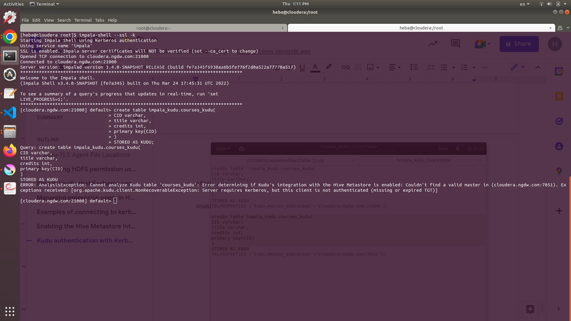

Hi ,
Kindly for your support, I'm trying to create a kudu table from impala shell after enabling kerberos but i got the following error:
ERROR: AnalysisException: Cannot analyze Kudu table 'courses_kudu': Error determining if Kudu's integration with the Hive Metastore is enabled: Couldn't find a valid master in (cloudera.ngdw.com:7051). Exceptions received: [org.apache.kudu.client.NonRecoverableException: Server requires Kerberos, but this client is not authenticated (missing or expired TGT)]
Kindly find attached steps and error returned. kerberos-kudu-impala-shell.png

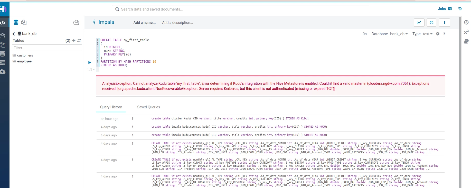

hebamahmoud
Silver ⭐️⭐️⭐️
Aug 29, 2022 3:18 PM UTC
Hi ,
I tried to create a kudu table from hue but i got the same error in impala shell , Kindly support.
Translate

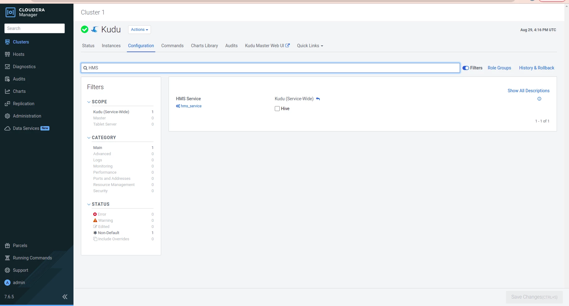

hebamahmoud
Silver ⭐️⭐️⭐️
Aug 29, 2022 4:18 PM UTC
Hi,
I checked cloudera runtime 7.1.7 know issues for kudu , i found that HMS integration isn't supported.  Although i disabled Kudu and HMS integration configuration , i'm still getting the same error message from impala shell and hue.
KuduHMS.pnge.
https://docs.cloudera.com/cdp-private-cloud-base/7.1.7/runtime-release-notes/topics/rt-pvc-known-issues-kudu.html
Kindly support.
Translate

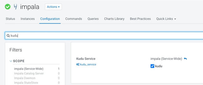

@hebamahmoud ,
Try enabling the Kudu Service as a dependency for the Impala service, as shown below.
When you do that Impala will use the selected Kudu service as the default service whenever you use a Kudu table that does not explicitly sets the Kudu masters.
If you don't set the property above you can still use Kudu from Impala but when you create the table you have to specify the Kudu masters through the TBLPROPERTIES clause.

hebamahmoud
Silver ⭐️⭐️⭐️
Sep 5, 2022 9:12 AM UTC
Dear @araujo ,
Many thanks , yes . This configuration is already enabled and configured.
Any recommendation for troubleshooting and investigating issue for configuring kudu kerberos in cloudera 7.1.7 runtime is highly appreciated.
