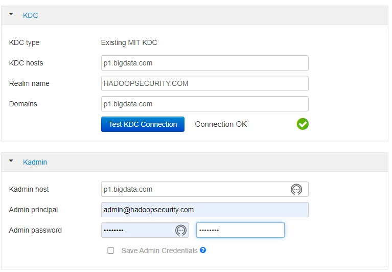

Here I am attaching the Config screenshot.  See if I am making any mistakes.
HDP Kerberos Error.jpgThere is no change in error even after your instructions.  Same error.

Shelton
Gold ⭐️⭐️⭐️
Oct 10, 2019 6:11 AM UTC
@vsrikanth9
1.Your KDC part of the screenshot has an error 🙂 in the domains part just copy and paste the below as is to replace p1.bigdata.com noe the dot(.)  and comma separating the names
.hadoopsecurity.com,hadoopsecurity.com
The validation passed because in reality it only test the connectivity ONLY to the KDC server
2. And then the Kadmin part the Admin principal should be the output of your
# kadmin.local
Something like admin/admin@hadoopsecurity.com or root/admin@hadoopsecurity.com
What ever you chose during the installation of Kerberos after that then launch the recreation of the keytabs and all should be okay.
Make sure the KDC server is up and running during this process.
Please revert

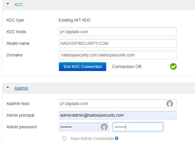

vsrikanth9
Gold ⭐️
Oct 10, 2019 12:10 PM UTC
is this what you are saying?

But still the same error.  I think something I am missing
