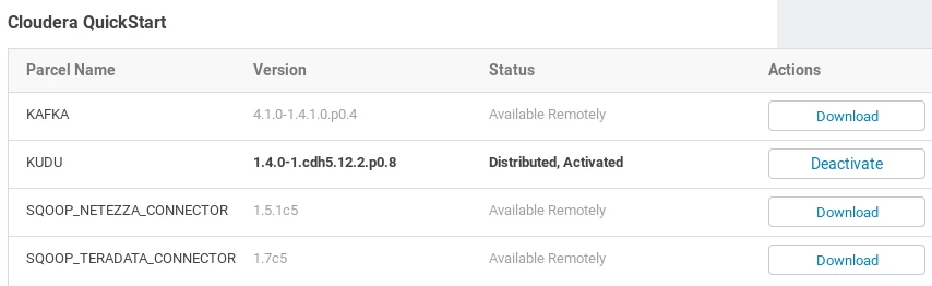

I am using cloudera quickstart 5.13.

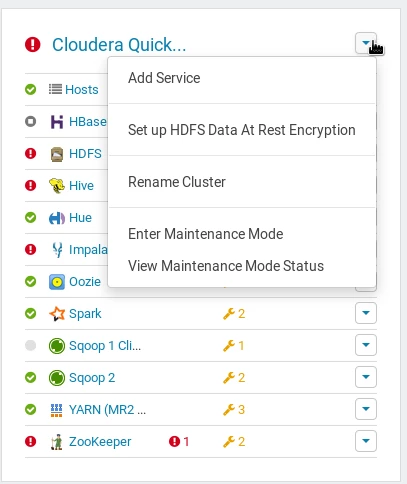

This is a phenomenon that the start and restart buttons of CM disappear as soon as you press add service to use kudu table and download kudu parcel(s).

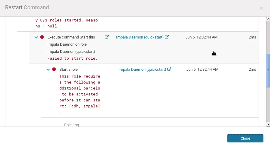

If you click the service arrow such as HDFS or Impala and click restart, the following error occurs.
How can I solve this?

@novice_tester This seems the CDH parcels getting deactivated. You have to make sure you have enough space on VM and them make sure CDH parcels are activated and then try to start the KUDU.
