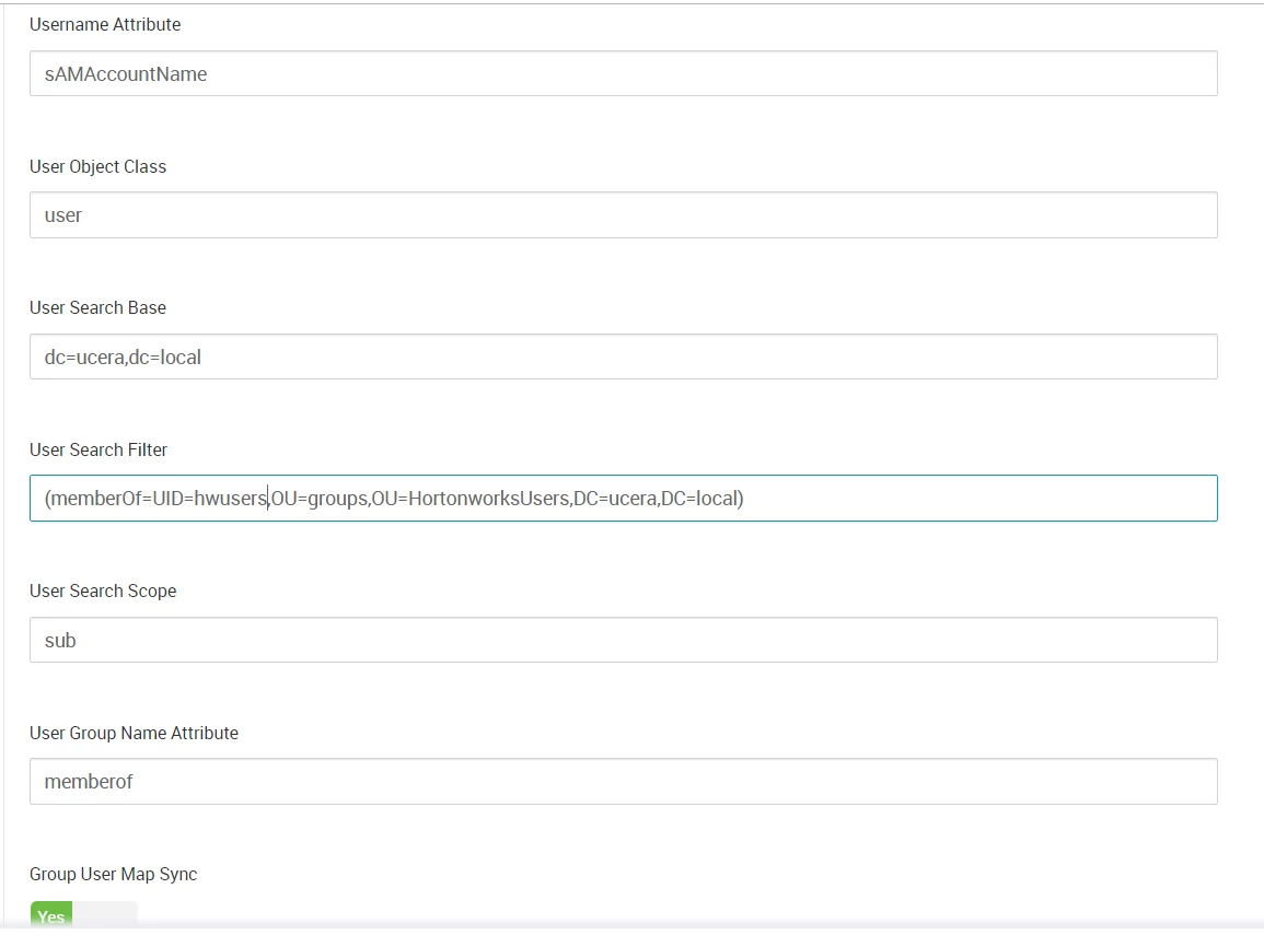

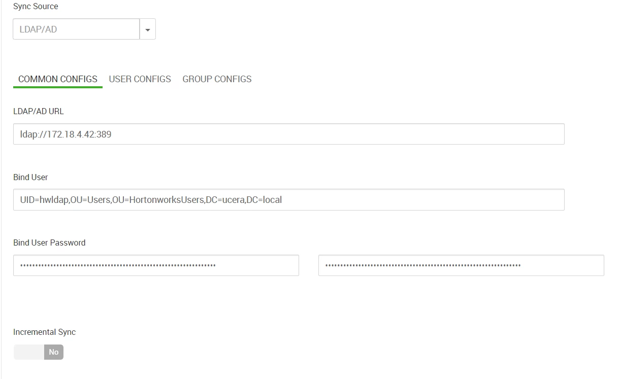

Attempting to set LDAP/AD users for Ranger (v1.2.0) following the docs (https://docs.cloudera.com/HDPDocuments/HDP3/HDP-3.1.4/configuring-ranger-authe-with-unix-ldap-ad/content/configuring_ranger_authentication_with_unix_ldap_or_ad.html) and this older video (https://www.youtube.com/watch?v=2aZ9GBhCOhA), but when looking at the Ranger Users tab in the Ranger UI, seeing only the original Unix users. In the UI I see...
Looking at the usersync logs, near the tail I see:
06 Dec 2019 14:21:51 INFO LdapUserGroupBuilder [UnixUserSyncThread] - LdapUserGroupBuilder initialization started
06 Dec 2019 14:21:51 INFO LdapUserGroupBuilder [UnixUserSyncThread] - LdapUserGroupBuilder initialization completed with -- ldapUrl: ldap://172.18.4.42:389, ldapBindDn: UID=hwldap,OU=Users,OU=HortonworksUsers,DC=ucera,DC=local, ldapBindPassword: ***** , ldapAuthenticationMechanism: simple, searchBase: dc=hadoop,dc=apache,dc=org, userSearchBase: [dc=ucera,dc=local], userSearchScope: 2, userObjectClass: user, userSearchFilter: (memberOf=UID=hwusers,OU=groups,OU=HortonworksUsers,DC=ucera,DC=local), extendedUserSearchFilter: (&(objectclass=user)(memberOf=UID=hwusers,OU=groups,OU=HortonworksUsers,DC=ucera,DC=local)), userNameAttribute: sAMAccountName, userSearchAttributes: [sAMAccountName, memberof], userGroupNameAttributeSet: [memberof], pagedResultsEnabled: true, pagedResultsSize: 500, groupSearchEnabled: false, groupSearchBase: [dc=ucera,dc=local], groupSearchScope: 2, groupObjectClass: group, groupSearchFilter: (CN=hwusers), extendedGroupSearchFilter: (&(objectclass=group)(CN=hwusers)(|(cn={0})(cn={1}))), extendedAllGroupsSearchFilter: (&(objectclass=group)(CN=hwusers)), groupMemberAttributeName: cn, groupNameAttribute: UID=hwusers,OU=groups,OU=HortonworksUsers,DC=ucera,DC=local, groupSearchAttributes: [UID=hwusers,OU=groups,OU=HortonworksUsers,DC=ucera,DC=local, cn], groupUserMapSyncEnabled: true, groupSearchFirstEnabled: false, userSearchEnabled: false, ldapReferral: ignore
06 Dec 2019 14:21:51 INFO UserGroupSync [UnixUserSyncThread] - Begin: initial load of user/group from source==>sink
06 Dec 2019 14:21:51 INFO LdapUserGroupBuilder [UnixUserSyncThread] - LDAPUserGroupBuilder updateSink started
06 Dec 2019 14:21:51 INFO LdapUserGroupBuilder [UnixUserSyncThread] - Performing user search first
06 Dec 2019 14:21:51 ERROR LdapUserGroupBuilder [UnixUserSyncThread] - LDAPUserGroupBuilder.getUsers() failed with exception: javax.naming.AuthenticationException: [LDAP: error code 49 - 80090308: LdapErr: DSID-0C09042F, comment: AcceptSecurityContext error, data 52e, v2580]; remaining name 'dc=ucera,dc=local'
06 Dec 2019 14:21:51 INFO LdapUserGroupBuilder [UnixUserSyncThread] - LDAPUserGroupBuilder.getUsers() user count: 0
06 Dec 2019 14:21:51 INFO UserGroupSync [UnixUserSyncThread] - End: initial load of user/group from source==>sink
So it seems like Ranger is trying to use AD, encountering an error, and falling back to Unix based users.
Did see this article (https://community.cloudera.com/t5/Community-Articles/Ranger-Ldap-Integration/ta-p/245494), but already have the cluster nodes linked to AD via SSSD, so would think the LDAP/AD sync should already be configured on the nodes and that Ranger should be able to use AD once the configs where entered.
Any idea what is going on here? Any further debugging tips or information (very unfamiliar with AD/LDAP admin stuff)?
rvillanueva
Gold ⭐️
Dec 9, 2019 10:42 PM UTC
Appears to have been able to sync AD users after changing the bing user path to:
CN=hwldap,OU=Users,OU=HortonworksUsers,DC=ucera,DC=local
as opposed to using the "uid" entry key.
IDK why this would make a difference, but seems to have worked. Would anyone with more AD experience have an idea why (note that when I look at the attributes for this entry in our AD both the CN and UID attributes are present)?

Doing a quick search for "LDAP Error 49":
LDAP Error 49 implies an authentication failure .... Typically, the Distinguished Name (DN) or the password is invalid...
I typically go through syncing LDAP users with Ambari, to discover all of the correct LDAP Settings.  Once this is compete, only then do I tackle deeper LDAP integration with Ranger.

From the Ranger email list, this is another bit of information that I found helpful:
I’ve configured ranger using the following approach to control who must be synced with AD. Only users belonging to groups inside a specific OU will be synced.
  1. I’ve created the OU  OU=ArthurAmericasGroups,OU=Security Groups,OU=Groups,OU=SHARED,OU=Brazil,DC=domain,DC=com
  2. Create a group called R2Users inside that OU. I put all desired sync users as its members. Also, you can put other groups as its member.  And, you can create other groups like R2TEAM as well. Remember to update this property ranger.usersync.ldap.user.searchfilter to include more than one.
  3. I’ve configured ranger to sync groups before users.
Here is the configuration.
in COMMON CONFIGS
Label
Property
Value
LDAP/AD URL
ranger.usersync.ldap.url
ldap://myacticedirectoryserver.domain.com:389
Bind User
ranger.usersync.ldap.binddn
CN=LDAP_AD_ACCOUNT,OU=Service Accounts,OU=LCB,OU=Brazil,DC=domain,DC=com
Bind User Password
ranger.usersync.ldap.ldapbindpassword
LDAP_AD_ACCOUNT user’s password
Inclemetal Sync
ranger.usersync.ldap.deltasync
Yes
Enable LDAP STARTTLS
ranger.usersync.ldap.starttls
No

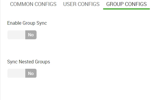

GROUP CONFIGS
Label
Property
Value
Enable Group Sync
ranger.usersync.group.searchenable
Yes
Group Member Attribute
ranger.usersync.group.memberattributename
member
Group Name Attribute
ranger.usersync.group.nameattribute
Cn
Group Object Class
ranger.usersync.group.objectclass
Group
Group Search Base
ranger.usersync.group.searchbase
Group Search Filter
ranger.usersync.group.searchfilter
Enable Group Search First
ranger.usersync.group.search.first.enabled
Yes
Sync Nested Groups
is_nested_groupsync_enabled
Yes
Group Hierarchy Levels
ranger.usersync.ldap.grouphierarchylevels
5
USER CONFIGS
Label
Property
Value
Username Attribute
ranger.usersync.ldap.user.nameatributte
sAMAccountName
User Object Class
ranger.usersync.ldap.objectclass
User
User Search Base
ranger.usersync.ldap.searchbase
DC=domain,DC=com
User Search Filter
(memberOf=CN=R2Users,OU=ArthurAmericasGroups,OU=Security Groups,OU=Groups,OU=SHARED,OU=Brazil,DC=domain,DC=com)
User Search Scope
ranger.usersync.ldap.user.searchscope
Sub
User Group Name Attribute
ranger.usersync.ldap.groupnameattribute
sAMAccountName
Group User Map Sync
ranger.usersync.group.usermapsyncenabled
Yes
Enable User Search
ranger.usersync.user.searchenabled
Yes
