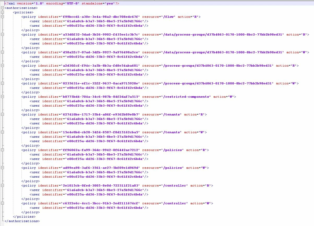

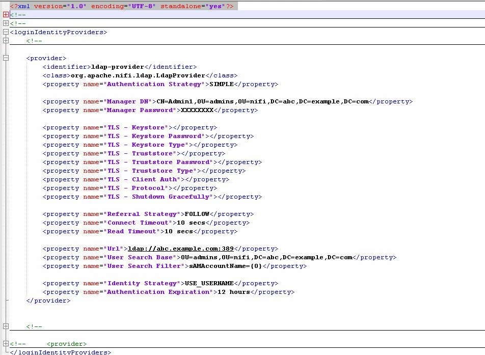

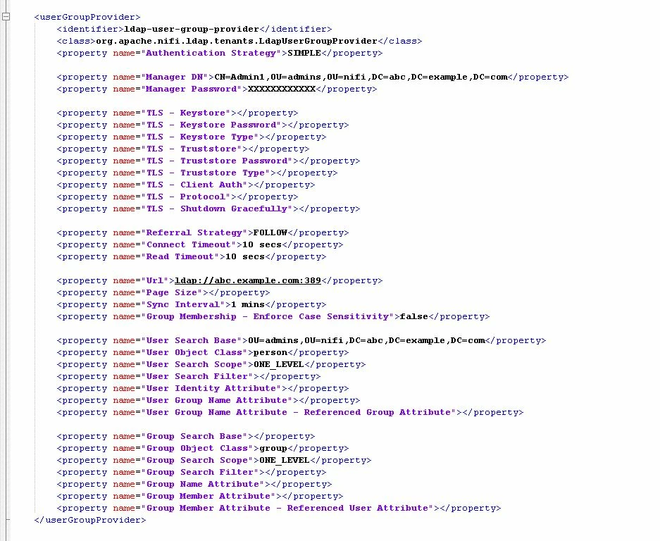

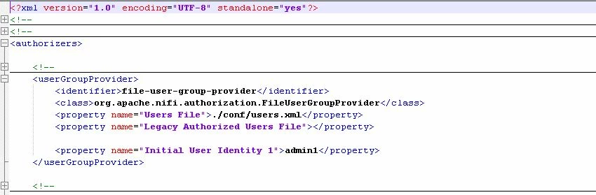

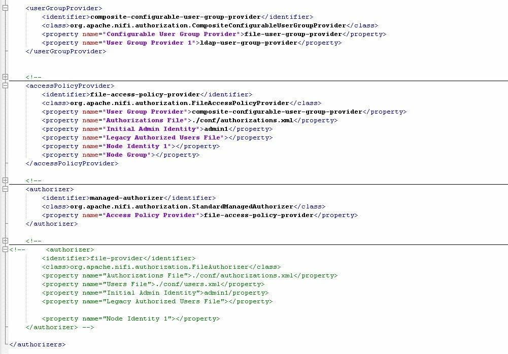

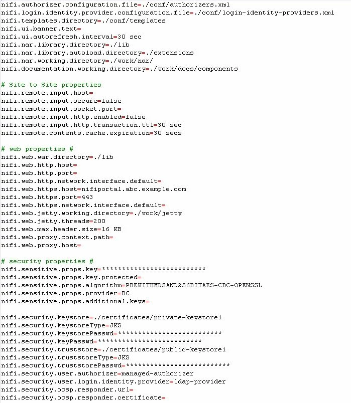

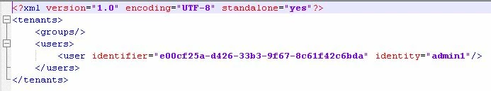

Dear All,
I am encountering issue with LDAP integration.
  1. I have completed LDAP (ldap-provider) and Certificate configurations according to documentation.
  2. I added IU certificate in NiFi (keystore, truststore etc.) and configured other pieces of the MS AD LDAP integration (authorizers.xml, login-identity-providers.xml and nifi.properties).

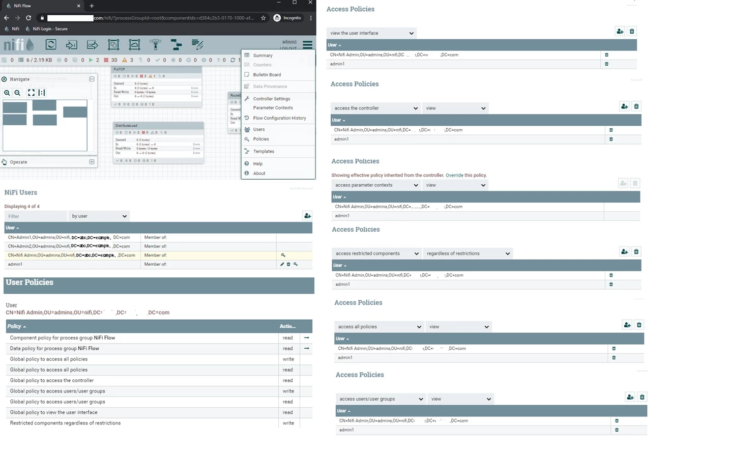

  3. I logged on NiFi from HTTPS UI with initial admin (admin1) and assigned the policies one of the LDAP users (nifiadmin) which is located on MS AD LDAP.
  4. I checked LDAP user (nifiadmin) from NiFi UI it is exist in the NiFi. It seems Ok. I added all screenshots (nifi_policies.jpg) about that.
  5. When I try to login initial admin (admin1) there is no error:
nifi-user.log:
2020-08-13 10:46:43,544 INFO [main] o.a.n.a.FileUserGroupProvider Users/Groups file loaded at Thu Aug 13 10:46:43 MSK 2020
2020-08-13 10:46:43,684 INFO [main] o.a.n.a.FileAccessPolicyProvider Authorizations file loaded at Thu Aug 13 10:46:43 MSK 2020
2020-08-13 11:21:28,051 INFO [NiFi Web Server-22] o.a.n.w.s.NiFiAuthenticationFilter Attempting request for (<JWT token>) GET https://nifiportal.abc.example.com/nifi-api/flow/current-user (source ip: 10.0.2.15)
2020-08-13 11:21:28,062 INFO [NiFi Web Server-22] o.a.n.w.s.NiFiAuthenticationFilter Authentication success for admin1
2020-08-13 11:21:28,167 INFO [NiFi Web Server-118] o.a.n.w.s.NiFiAuthenticationFilter Attempting request for (<JWT token>) GET https://nifiportal.abc.example.com/nifi-api/flow/client-id (source ip: 10.0.2.15)
2020-08-13 11:21:28,170 INFO [NiFi Web Server-118] o.a.n.w.s.NiFiAuthenticationFilter Authentication success for admin1
2020-08-13 11:21:28,170 INFO [NiFi Web Server-22] o.a.n.w.s.NiFiAuthenticationFilter Attempting request for (<JWT token>) GET https://nifiportal.abc.example.com/nifi-api/flow/config (source ip: 10.0.2.15)
2020-08-13 11:21:28,179 INFO [NiFi Web Server-22] o.a.n.w.s.NiFiAuthenticationFilter Authentication success for admin1
2020-08-13 11:21:28,206 INFO [NiFi Web Server-118] o.a.n.w.s.NiFiAuthenticationFilter Attempting request for (<JWT token>) GET https://nifiportal.abc.example.com/nifi-api/flow/banners (source ip: 10.0.2.15)
      6. But, when I try to login with LDAP User (nifiadmin) who was already assigned NiFi UI access by me I am getting permission error. I added all screenshots (nifi_policies.jpg) about that:
nifi-user.log:
2020-08-13 11:51:52,255 INFO [NiFi Web Server-16] o.a.n.w.s.NiFiAuthenticationFilter Attempting request for (<JWT token>) GET https://nifiportal.abc.example.com/nifi-api/flow/current-user (source ip: 10.0.2.15)
2020-08-13 11:51:52,258 INFO [NiFi Web Server-16] o.a.n.w.s.NiFiAuthenticationFilter Authentication success for nifiadmin
2020-08-13 11:51:52,260 INFO [NiFi Web Server-16] o.a.n.w.a.c.AccessDeniedExceptionMapper identity[nifiadmin], groups[] does not have permission to access the requested resource. Unknown user with identity 'nifiadmin'. Returning Forbidden response.
      7. When I check the nifi-app.log there is no error:
nifi-app.log:
2020-08-13 10:46:52,310 INFO [main] o.e.jetty.util.ssl.SslContextFactory x509=X509@1b8354aa(fa3f2599-3d3b-43c9-9e7a-ea26375d4470,h=[nifiportal.abc.example.com],w=[]) for SslContextFactory@378a5302[provider=null,keyStore=file:///C:/nifi/certificates/private-keystore1,trus
tStore=file:///C:/nifi/certificates/public-keystore1]
2020-08-13 10:46:52,325 INFO [main] o.eclipse.jetty.server.AbstractConnector Started ServerConnector@2794eab6{SSL,[ssl, http/1.1]}{nifiportal.abc.example.com:443}
2020-08-13 10:46:52,325 INFO [main] org.eclipse.jetty.server.Server Started @31030ms
2020-08-13 10:46:52,419 INFO [main] org.apache.nifi.nar.NarAutoLoader Starting NAR Auto-Loader for directory .\extensions ...
2020-08-13 10:46:52,419 INFO [main] org.apache.nifi.nar.NarAutoLoader NAR Auto-Loader started
2020-08-13 10:46:52,419 INFO [main] org.apache.nifi.web.server.JettyServer NiFi has started. The UI is available at the following URLs:
2020-08-13 10:46:52,419 INFO [main] org.apache.nifi.web.server.JettyServer https://nifiportal.abc.example.com:443/nifi
      8. What I did for solving the problem
  • I deleted user.xml and authorizations.xml several times. Nifi creates automatically them but problem is still continue.
  • I tried different kind of the configurations in the related files (authorizers.xml, login-identity-providers.xml and nifi.properties). But no change
  • I also tried another LDAP user than nifiadmin (admin2) but there is no any solution for ldap user login issue
I added all configuration files (authorizations, authorizers, login-identity-providers, nifi.properties and users) with jpeg format. I also added screenshots (nifi_policies.jpg) about access and user policies.
My environment details are below:
Apache NiFi 1.11.3 (single, not cluster)
Windows Server 2016
Java JRE 1.8.0_251 (64 Bit)
MS Active Directory 2016 for LDAP
Do you have any comment or idea?
nifi_policiesnifi_policiesauthorizations.xmlauthorizations.xmlauthorizers-1.xmlauthorizers-1.xmlauthorizers-2.xmlauthorizers-2.xmlauthorizers-3.xmlauthorizers-3.xmllogin-identity-providers.xmllogin-identity-providers.xmlnifi.propertiesnifi.propertiesusers.xmlusers.xml
