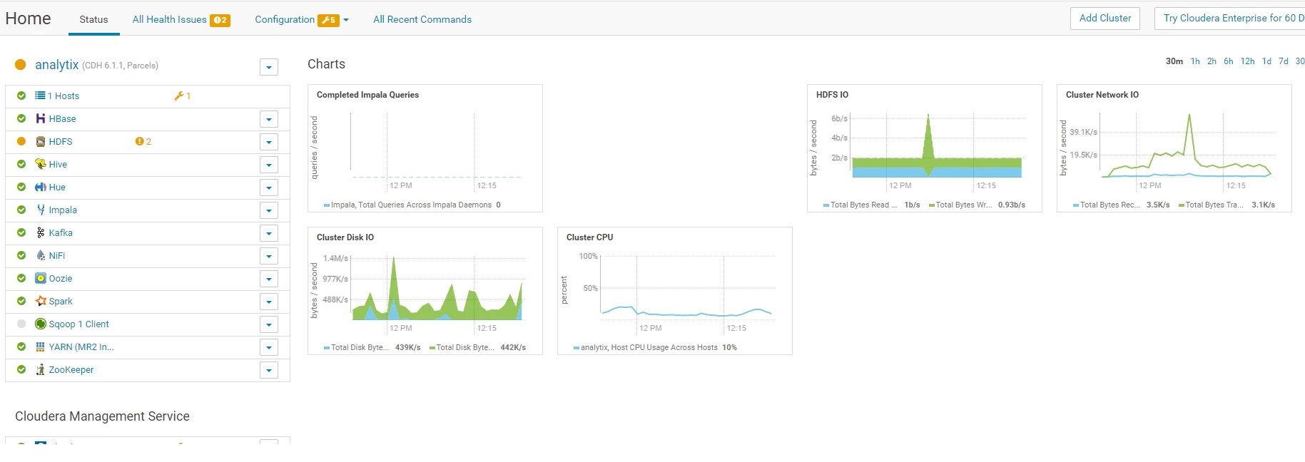

Hi ,
When i passed to level3 .all seems good and well-configured .
The error is not been  re-showen again .
Thanks.

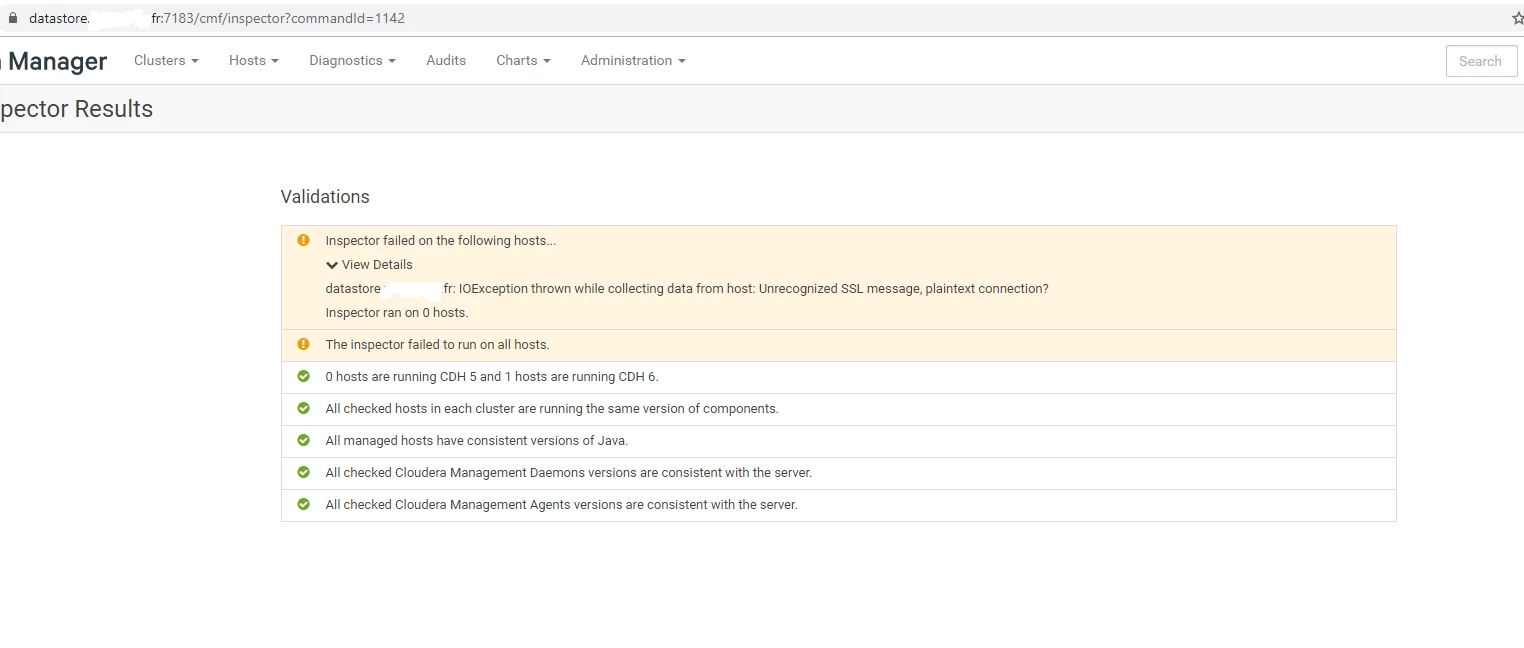

i resolved that by ,adding my rootca to my cloudera keystore and trustore .Then i reconfigured  the agent config.ini to point to the rootca.pem .
But when i inspect host i got this error .(i am using cdh 6.1.1 on ubuntu 16.04)

lhebert
Gold ⭐️
Gold ⭐️
Dec 19, 2019 3:04 PM UTC
Hello,
Take a look at the Agent configuration on the reported host and make sure that use_tls is set to 1 and not 0. This error usually happens when Cloudera Manager expects TLS from the agent (Based on enabled options
) but the agent is continuing to send data using clear text. If the parameter is set to 1 please restart the agent to ensure that it is set properly.
The agent performs multiple task some of these task are performed with data transmitted through the heartbeat others are handled by a pull method through the agent.
Translate
