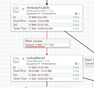

- I have a lookupRecord processor to enrich data and the queue become full for it so i guess this processor is the problem but it never had this behavior before

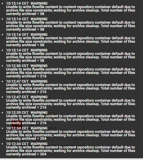

- Nifi tell me it's unable to write flowfile content to content repo due to archive file size constraint
- The input processor of the flow is a listenUDP and warn me that the internal queue is full
I tried to reboot everything, obsioulsy, and also to increase JVM memory settings to Xmx12g to be sure it's not a lack of memory.
I saw that the archive cleanup issue could be a bug from Nifi but I'm actually on 1.17 and even tried to move to 1.20 and everything is same.
