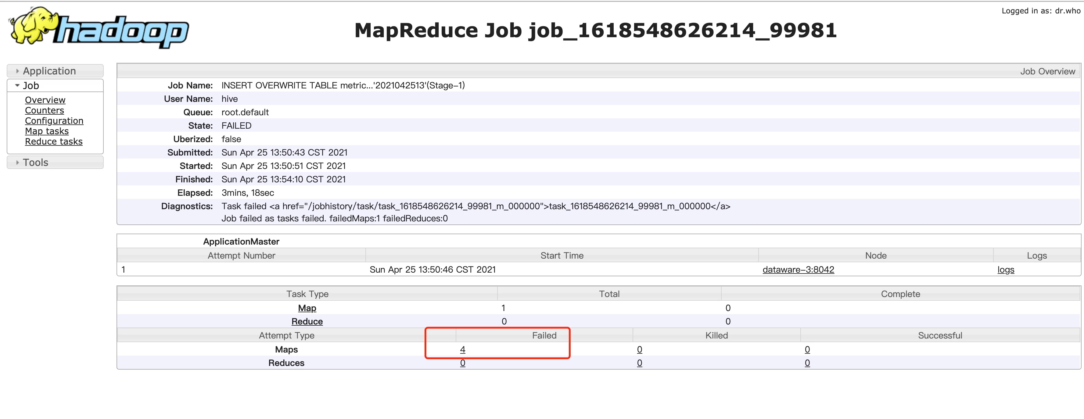

MapReduce failed since Task connection timeout with App master
Recently, MapReduce job sometimes failed, the details as below:
after check map tasks , the log like below:

from the above log, we can see the task connection timeout with App master, but this error happend randomly, who can give me some advises on this error.
thanks.

this issue has been solved right now. and the investigation road likes below:
when i got this issue from development team, these peoples told me some tasks will be failed, and asked me how to solve it.
then i open Yarn web ui to check what's exact errors of this issue, and found the connection time out. this is the first vision i have got.
so i was considering why the port can't connect ? maybe there is a firewall ?  or maybe one machine got some problem, when task assigned to this machine, then this issue happended?
these all are my assumption, and after two days checked, the answer is no. since no firewall, and this issue happended randomly on every machine.
just yesterday night, i found if the connection port is near 1000, then the job failed and connection timeout, but if the port is near 30000+, there are no any issue happend.
so i am going to check the sysctl.conf, i found the setting for port range is "net.ipv4.ip_local_port_range = 1024 65000",
at last i set the port range between "32678. 655000", this issue has been solved.
