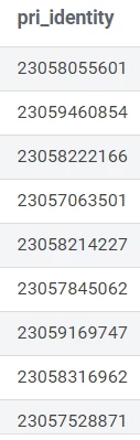

Hi @roshanbi
I think there are really two questions here:
  • For each row of my data set, can I mask the last 5 digits of each data element present in the pri_identity column using Ranger?
  • Is this possible to achieve while using Kudu?
I'll restrict myself to addressing the first question. Your second question is a good one, though, because most of the documentation I've read about this simply doesn't mention Kudu, so I'll leave that part of your question to another community member who has more experience with Apache Kudu as a storage option. You didn't provide the version of either Impala, Ranger or Kudu you're using or on what distribution, but I will attempt to point you in the right direction nonetheless.

To suppress the display of the last 5 digits in the pri_identity column, you are likely to need a custom masking expression for use in Ranger. Ranger includes several "out of the box" masking types, but a cursory look at the documentation indicates that the masking policy you've described and desire is not one of them. If that's true, you can always write a custom masking expression using the UDF syntax, which you can read about at the Apache.org site here:
Hive Operators and User-Defined Functions (UDFs)
Hope this helps
