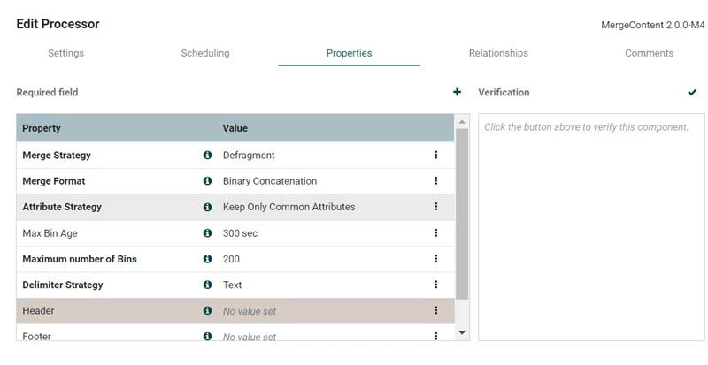

I am using NIFI 2.0 M4 version-single node , I am trying to merge flow files using defragment merge strategy, Instead of merging all defragment flow files  , It is writing first fragment to merged and remaining to failure, Please suggest if i am missing some thing.
NIFI Configuration:

I find it odd that you say 1 FlowFile is routed to "merged".  This implies the a merge was success.  Are you sure the "merged" FlowFile only contains the content of one FlowFile from the set of fragments?
Any chance you routed both the "original" and "failure" relationships to the same connection?  Can you share the full MergeContent processor configuration (all tabs)?
When a FlowFile is routed to "failure", I would expect to see logging in the nifi-app.log related to reason for the failure.  What do you see in the nifi-app.log?
How many unique bundles are you trying to merge concurrently?  I see you have set "Max Num Bins" to 200.  So you expect to have 200 unique fragment.identifier bundles to merge at one time?
How many FlowFiles typically make up one bundle?
I also see you have "Max Bin Age" set to 300 sec (5 mins).  Are all FlowFiles with same fragment.identifier making it to the MergeContent processor within the 5 minute of one another?
