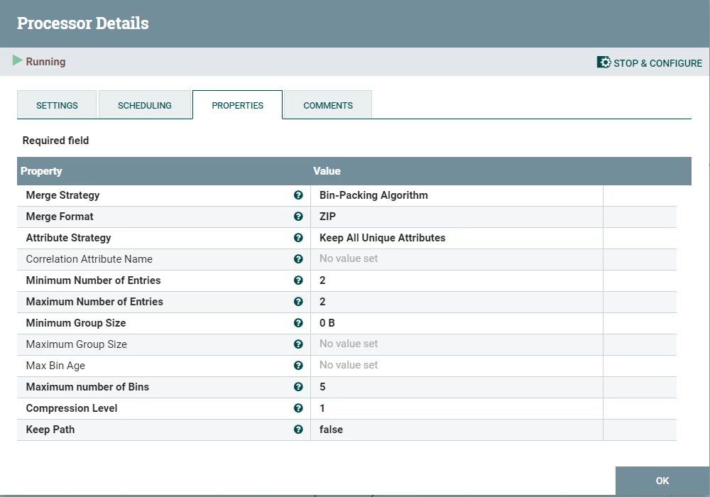

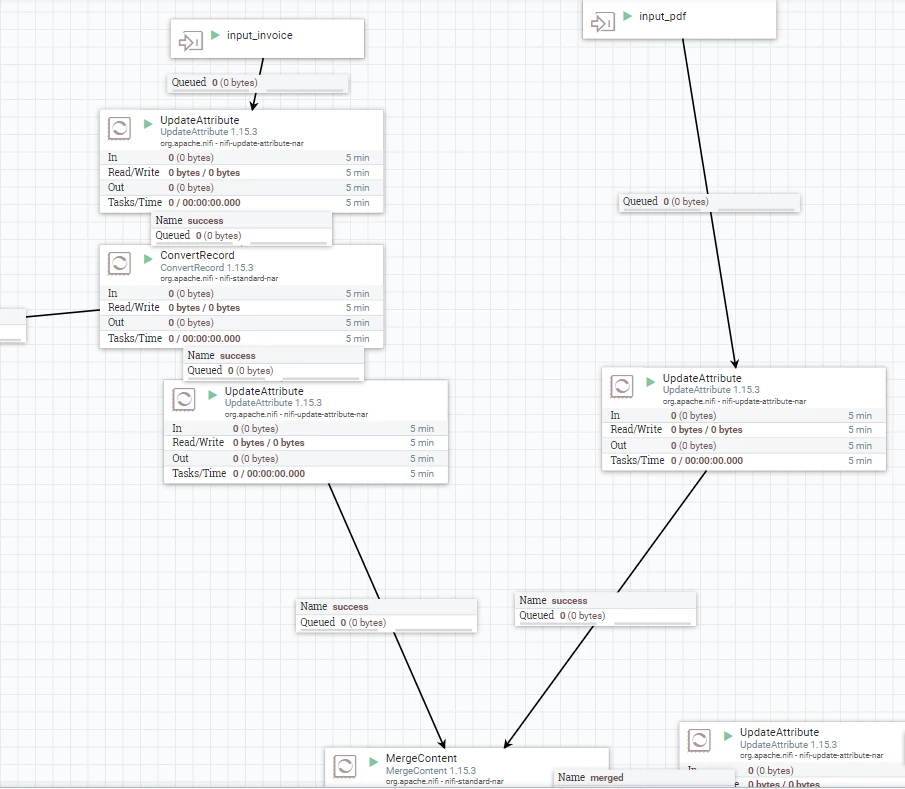

          i've a flow  where there two flows one for xml file and other for corresponding Pdf file. Currently i'm merging those using Mergecontent and generating the zip file out of it.  by making sure minimum entries 2.
if input files load are heavy the merge is not matching  corresponding file means (same invoice file should be merged) but sometimes other invoice file merging due to big load from input at a time. i already implemented 10 secs delay  for each flow and merging two files. is there a mechanism to merge files based on common attribute before mergecontent.

Is the invoice number unique? If the filename matches between the two format, have you tried using this instead? Of course you have to derive just the filename without the extension in another attribute first and then use the new attribute for the Correlation Attribute. Also try resetting the "Minimum Number of Entries" to 1 . If none of that helped can you please post screenshot of the mergeContent processor configurations with other critical processors configurations as well.

Actually the input is single one i.e. JSON file will be converted to xml and pdf and later we need to implement this logic  merging together and send it business. we need to merge in such a way same invoicenumber XML and pdf.
