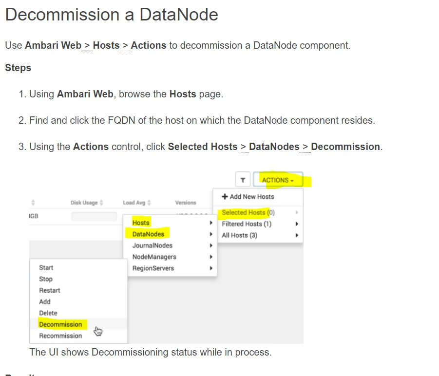

It's well documented in by hortonworks Once you launch the decommissioning the blocks on that node will be distributed to the other node remaining nodes
If the replication factor is higher than the number of existing data nodes after the removal, the removal process is not going to succeed!

Surely you could just t^do that but what happens to the replicas stored on that particular data node? Somehow your cluster has to reconstruct those replicas if you had a replicator factor of more than 1.
Here I was talking about planned maintenance! Just switching it off will also force your cluster to do the same thing in the background with alerts and ONLY when the replicas have been reconstructed will those alerts go away.
There is a performance cost for both decommissioning and just unplugging the data node.
