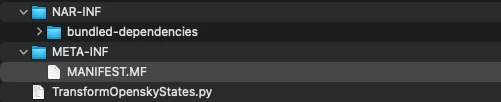

My directory structure looks like this based on the documentation -
I don't include anything under bundled dependencies and my MANIFEST.MF looks like this.

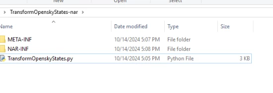

3- Created the folder structure as follows:
3 - Under the META-INF I have created the MANIFEST.FM and add the following text:

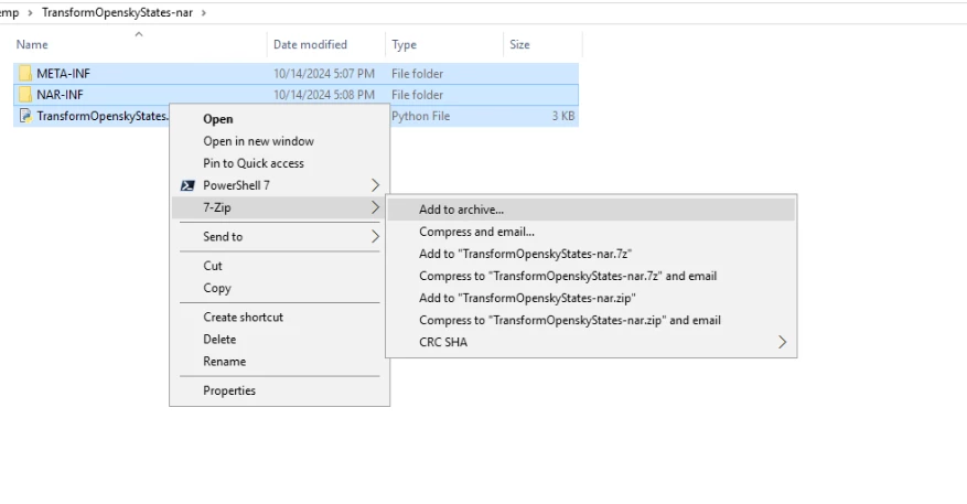

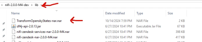

5-  I have downloaded and installed 7-zip then I went inside the main directory created at step 1 , selected all (2 folders and 1 py file) , right click , select 7-Zip menu item and then select Add to Archive

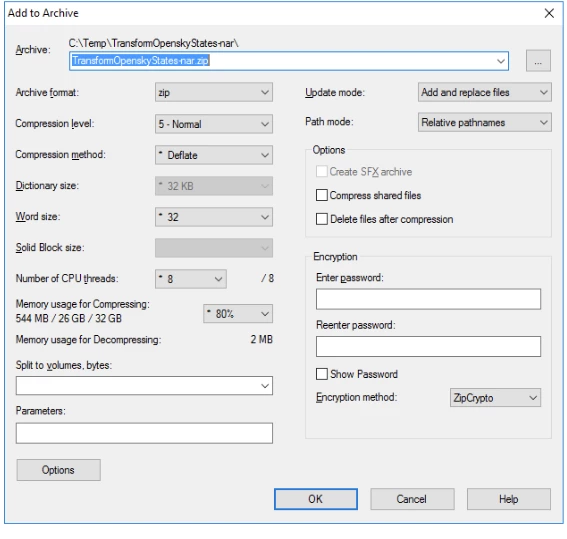

6- In the 7-Zip Add To Archive window,  type the name of your package and save as .zip. No need to change any configuration. If you create a zip file on the main folder level then it will add the main folder to the package and that might cause problem as nifi expects the py file to be on the root level and that could be your probelm.
7- rename the .zip to .nar and then I would try first to place it under the lib folder and if it works you can move it to others.
8 - Restart Nifi and in my case the log file had the following entries regarding this processor:

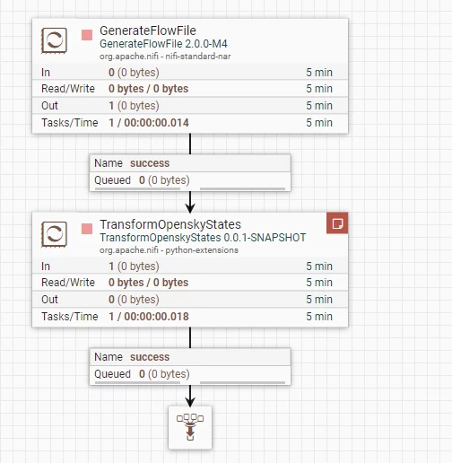

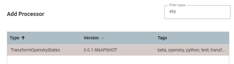

9- Once UI is up and running , I m able to see and select the processor:
When I ran it however I got an error but that is a different story 🙂

Thanks so much - Here are my further findings...
Here is my current directory structure -
I tried a bunch of different ways to zip this and put the .nar in the corresponding NIFI_HOME/lib directory.
Here is each test case running on my Mac OS. Please ignore the naming conventions as I was trying to go through this quickly 😊
Test Case 1: Normal zip
Failed
zip -r archive_name.zip TransformOpenskyStates.py NAR-INF/ META-INF/
cp archive_name.zip ../Downloads/nifi-2.0.0-M4/lib/archive_name.nar

Test Case 5: Running Zip Command inside TransformOS-nar directory with *
Passed!!
zip -r archive_name.zip *
Now you are probably wondering what the difference is between Test Case 1 and Test Case 5 is... To go in further detail, here's the output of each zip command -
Zip command output for Test Case 1:
drewnicolette@MacBook-Pro-2:~/TransformOS-nar
$ zip -r archive_name.zip TransformOpenskyStates.py NAR-INF/ META-INF/
adding: TransformOpenskyStates.py (deflated 60%)
adding: NAR-INF/ (stored 0%)
adding: NAR-INF/.DS_Store (deflated 96%)
adding: NAR-INF/bundled-dependencies/ (stored 0%)
adding: META-INF/ (stored 0%)
adding: META-INF/MANIFEST.MF (deflated 13%)
adding: META-INF/.DS_Store (deflated 97%)
Zip command output for Test Case 5:
$ zip -r archive_name.zip *
It seems like it's zipping up the same files and the byte count for each .zip file are the same! Please see screenshot below!
Solution: Order matters when zipping up the file! If you look above in Test Case 1, when I ran the zip command, it added TransformOpenskyStates.py first, while in Test Case 5 it added META-INF/ first.
I believe NiFi code is expecting META-INF/ first?? @MattWho - Do you know anything about this?
