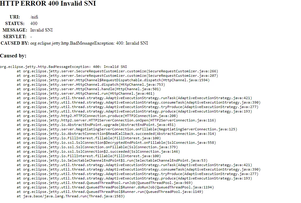

2- After upgrading to Java 21, Im able to start nifi using default configuration, the log file doesn't show any error and default username and password are generated, however when I try to browse for  https://127.0.0.1:8443/nifi I get the following error:
Not sure if this is something local to my machine but upon some internet search, I replaced url from 127.0.0.1 to localhost and it worked as I get to  the log in screen.

2. The SNI exception is caused by using an IP or using a hostname not found within the SAN of the PrivateKeyEntry located in the NiFi keystore.  This is per spec for Java 21.
