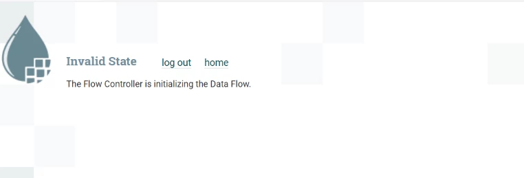

Good Day,
we are experiencing new error called"  Connection refused: zookeepernode2" post setting up DNS  with the keystore and Password for NIFI which we generated internally using keytool, same keystore and password we are using in zookeeper as well.
Attaching the Required details, Request you to please check and provide your valuable feedback
Below is the web UI error.

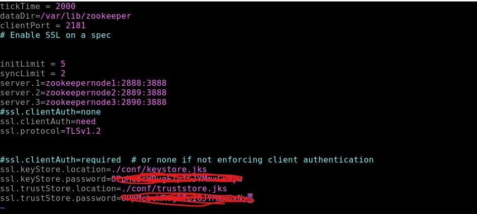

we setted up the nifi cluster in below format
NIFINODE1, NIFINODE2. two azure vm's
Zookeepernode1, Zookeepernode2, Zookeepernode3. three Azure vm's
please find zoo,cfg details below.
#zookeeper node3 has been choosen has an elector
sudo bin/zkServer.sh status
/usr/bin/java
ZooKeeper JMX enabled by default
Using config: /opt/zookeeper/bin/../conf/zoo.cfg
Client port not found in static config file. Looking in dynamic config file.
grep: : No such file or directory
Client port not found in the server configs
Client port found: 2181. Client address: localhost. Client SSL: false.
Mode: leader
___________________________________________________________________________

# cluster node properties (only configure for cluster nodes) #
nifi.cluster.is.node=true
nifi.cluster.node.address=nifinode1.web
nifi.cluster.node.protocol.port=9991
nifi.cluster.node.protocol.max.threads=50
nifi.cluster.node.event.history.size=25
nifi.cluster.node.connection.timeout=5 sec
nifi.cluster.node.read.timeout=5 sec
nifi.cluster.node.max.concurrent.requests=100
nifi.cluster.firewall.file=
nifi.cluster.flow.election.max.wait.time=1 mins
nifi.cluster.flow.election.max.candidates=
# cluster load balancing properties #
nifi.cluster.load.balance.host=nifinode1.web
nifi.cluster.load.balance.port=6342
nifi.cluster.load.balance.connections.per.node=1
nifi.cluster.load.balance.max.thread.count=8
nifi.cluster.load.balance.comms.timeout=30 sec
nifi.cluster.protocol.ssl.context.protocol=TLS
# zookeeper properties, used for cluster management #
nifi.zookeeper.connect.string=zookeepernode1:2181,zookeepernode2:2181,zookeepernode3:2181
#nifi.zookeeper.connect.string=zookeepernode1:2181,zookeepernode2:2182,zookeepernode3:2183
nifi.zookeeper.connect.timeout=10 secs
nifi.zookeeper.session.timeout=10 secs
nifi.zookeeper.root.node=/nifi
#nifi.zookeeper.client.secure=false
nifi.zookeeper.ssl.clientAuth=none
nifi.zookeeper.client.secure=true
nifi.zookeeper.security.keystore=./conf/keystore.jks
nifi.zookeeper.security.keystoreType=jks
nifi.zookeeper.security.keystorePasswd=OXXXXXXXXXXXXXXXNyw
nifi.zookeeper.security.truststore=./conf/truststore.jks
nifi.zookeeper.security.truststoreType=jks
nifi.zookeeper.security.truststorePasswd=OXXXXXXXXXXXXXGxNyw
nifi.zookeeper.jute.maxbuffer=

logs/nifi-app.log error details
2025-02-19 10:02:01,616 INFO [epollEventLoopGroup-4-1] o.apache.zookeeper.ClientCnxnSocketNetty channel is disconnected: [id: 0xf6690cd4, L:/53.13.138.70:53038 ! R:zookeepernode2/53.13.138.7
2:2181]
2025-02-19 10:02:01,616 INFO [epollEventLoopGroup-4-1] o.apache.zookeeper.ClientCnxnSocketNetty channel is told closing
2025-02-19 10:02:02,157 INFO [epollEventLoopGroup-4-1] o.apache.zookeeper.ClientCnxnSocketNetty SSL handler added for channel: [id: 0x48429c0b]
2025-02-19 10:02:02,158 INFO [epollEventLoopGroup-4-1] o.apache.zookeeper.ClientCnxnSocketNetty channel is connected: [id: 0x48429c0b, L:/53.13.138.70:34056 - R:zookeepernode1/53.13.138.71:2
181]
2025-02-19 10:02:02,159 INFO [epollEventLoopGroup-4-1] o.apache.zookeeper.ClientCnxnSocketNetty channel is disconnected: [id: 0x48429c0b, L:/53.13.138.70:34056 ! R:zookeepernode1/53.13.138.7
1:2181]
2025-02-19 10:02:02,159 INFO [epollEventLoopGroup-4-1] o.apache.zookeeper.ClientCnxnSocketNetty channel is told closing
2025-02-19 10:02:02,159 WARN [main] o.a.n.c.l.e.CuratorLeaderElectionManager Unable to determine leader for role 'Cluster Coordinator'; returning null
org.apache.zookeeper.KeeperException$ConnectionLossException: KeeperErrorCode = ConnectionLoss for /nifi/leaders/Cluster Coordinator
at org.apache.zookeeper.KeeperException.create(KeeperException.java:101)
at org.apache.zookeeper.KeeperException.create(KeeperException.java:53)
at org.apache.zookeeper.ZooKeeper.getChildren(ZooKeeper.java:2480)
at org.apache.curator.framework.imps.GetChildrenBuilderImpl$3.call(GetChildrenBuilderImpl.java:235)
at org.apache.curator.framework.imps.GetChildrenBuilderImpl$3.call(GetChildrenBuilderImpl.java:228)
at org.apache.curator.RetryLoop.callWithRetry(RetryLoop.java:88)
at org.apache.curator.framework.imps.GetChildrenBuilderImpl.pathInForeground(GetChildrenBuilderImpl.java:228)
at org.apache.curator.framework.imps.GetChildrenBuilderImpl.forPath(GetChildrenBuilderImpl.java:221)
at org.apache.curator.framework.imps.GetChildrenBuilderImpl.forPath(GetChildrenBuilderImpl.java:42)
at org.apache.curator.framework.recipes.locks.LockInternals.getSortedChildren(LockInternals.java:133)
at org.apache.curator.framework.recipes.locks.LockInternals.getParticipantNodes(LockInternals.java:119)
at org.apache.curator.framework.recipes.locks.InterProcessMutex.getParticipantNodes(InterProcessMutex.java:153)
at org.apache.curator.framework.recipes.leader.LeaderSelector.getLeader(LeaderSelector.java:321)
at org.apache.nifi.controller.leader.election.CuratorLeaderElectionManager.getLeader(CuratorLeaderElectionManager.java:288)
at org.apache.nifi.cluster.coordination.node.LeaderElectionNodeProtocolSender.getServiceAddress(LeaderElectionNodeProtocolSender.java:46)
at org.apache.nifi.cluster.protocol.AbstractNodeProtocolSender.requestConnection(AbstractNodeProtocolSender.java:64)
at org.apache.nifi.cluster.protocol.impl.NodeProtocolSenderListener.requestConnection(NodeProtocolSenderListener.java:89)
at org.apache.nifi.controller.StandardFlowService.connect(StandardFlowService.java:928)
at org.apache.nifi.controller.StandardFlowService.load(StandardFlowService.java:476)
at org.apache.nifi.web.server.JettyServer.start(JettyServer.java:896)
at org.apache.nifi.NiFi.<init>(NiFi.java:172)
at org.apache.nifi.NiFi.<init>(NiFi.java:83)
at org.apache.nifi.NiFi.main(NiFi.java:332)
2025-02-19 10:02:02,159 WARN [main] o.a.nifi.controller.StandardFlowService There is currently no Cluster Coordinator. This often happens upon restart of NiFi when running an embedded ZooKee
per. Will register this node to become the active Cluster Coordinator and will attempt to connect to cluster again
2025-02-19 10:02:02,159 INFO [main] o.a.n.c.l.e.CuratorLeaderElectionManager CuratorLeaderElectionManager[stopped=false] Attempted to register Leader Election for role 'Cluster Coordinator'
but this role is already registered
2025-02-19 10:02:02,343 INFO [epollEventLoopGroup-4-1] o.apache.zookeeper.ClientCnxnSocketNetty SSL handler added for channel: [id: 0x0703dfdc]
2025-02-19 10:02:02,344 INFO [epollEventLoopGroup-4-1] o.apache.zookeeper.ClientCnxnSocketNetty channel is connected: [id: 0x0703dfdc, L:/53.13.138.70:39036 - R:zookeepernode3/53.13.247.198:
2181]
2025-02-19 10:02:02,345 INFO [epollEventLoopGroup-4-1] o.apache.zookeeper.ClientCnxnSocketNetty channel is disconnected: [id: 0x0703dfdc, L:/53.13.138.70:39036 ! R:zookeepernode3/53.13.247.1
98:2181]
2025-02-19 10:02:02,345 INFO [epollEventLoopGroup-4-1] o.apache.zookeeper.ClientCnxnSocketNetty channel is told closing
vg27
vg27Answer
Gold ⭐️
Mar 6, 2025 1:30 PM UTC
Hi All,
Issue got Resolved, Issue was with the certications, access keys sand keystore got generated wrong,
Post generating the new keys, issue was resolved
4 replies
vg27
vg27Author
Gold ⭐️
Feb 19, 2025 12:49 PM UTC
Also used the trustore and keystore from the certficate which is genearted from the DNS level nifi-web-net.
we have DNS c-name for NIFI vm's and zookeeper vm's
like nifinode1.web.net, nifinode2.web.net
zookeepernode1.web.net. zookeepernode2.web.net
can you guide us to generate certficate  based on DNS level or each VM level..?
