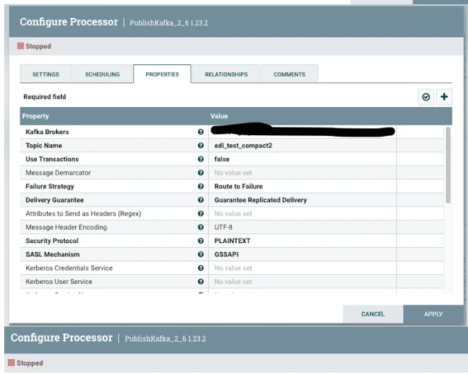

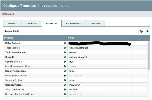

I'm using ConsumeKafka and PublishKafka processors to replicate topics.

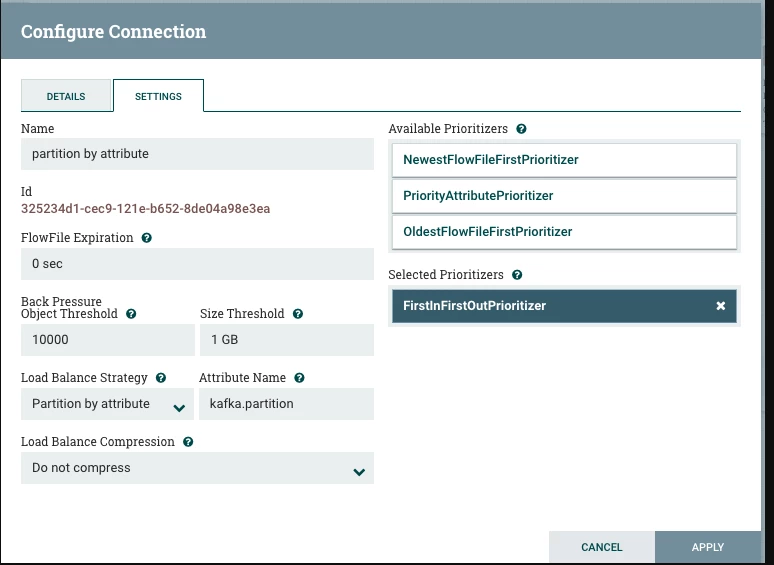

Upon examination, implementing the queue as a First In First Out prioritizer and configuring the load balancing strategy to Partition by attribute with the kafka.partition attribute has proven effective in maintaining the order.

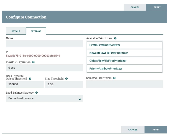

2. When using ConsumeKafka, try using EnforceOrder processor after ConsumeKafka configured to order FlowFiles by the offset.  Then make sure that all connections downstream of EnforceOrder processor to PublishKafka use "FirstInFirstOutPrioritizer" (by default no prioritizer is set on a connection).

4. Make sure that all connections downstream of PublsihKafkaRecord processor to PublishKafkaRecord processor use "FirstInFirstOutPrioritizer" (by default no prioritizer is set on a connection).
