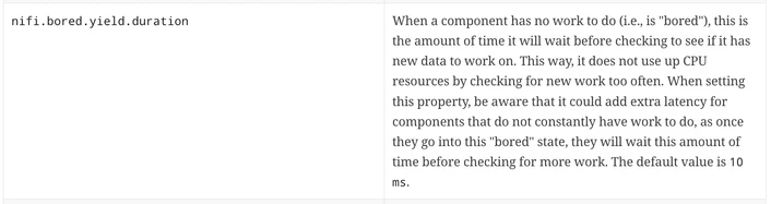

To adjust this setting, you can change the following property in the nifi.properties file:
nifi.bored.yield.duration found in Core Properties section of admin guide.
Keep in mind that this setting impacts all processors.  So higher you set the more latency that could exist before new work is found after a run that resulted in no work.
You can also selectively adjust the run schedule on select processors. 0 sec run schedule means to run as fast as possible.  So as soon as one thread completes, request another (unless thread results in no work wait bored duration before requesting next thread).  So if you have flows that are always very light and latency is not a concern, you could set those processors to only get scheduled to execute every 1 sec or longer.
