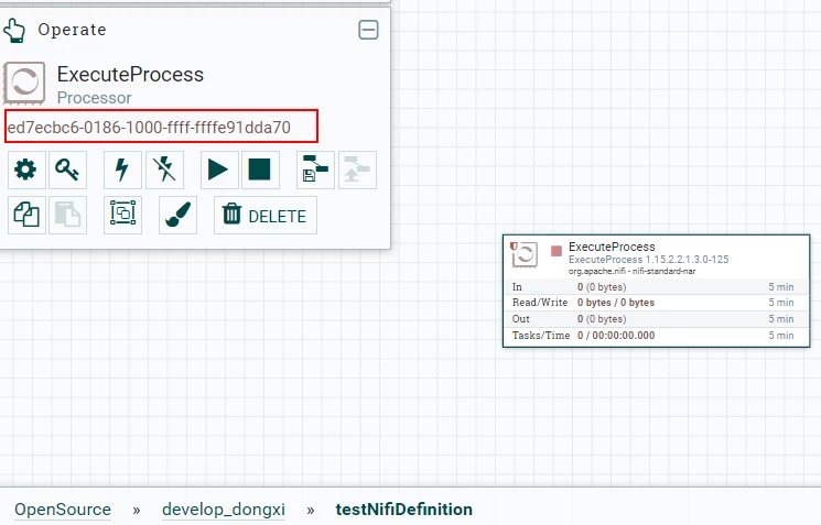

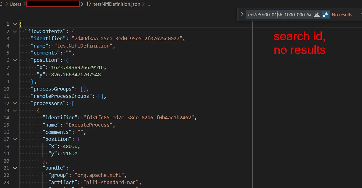

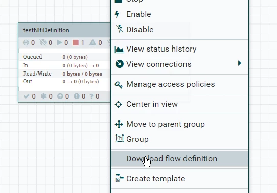

I download Nifi flow definition on a Process Group. Then I search the real id of a processor and get nothing. Why the definition does not keep everything as same as those in a Nifi flow?
I need to compare two Nifi flows in two environment, DEV and UAT. But the definition does not keep all processors' identifier. It is so difficult for me to find differences.

If I may intervene here for a second, I would say that I totally agree with what @MattWho said but in the same time, I think that what you, @wffger2, are trying to achieve might be partially possible.You would still need everything what Matt said, but if you just want to double check and confirm your IDs within your definition flow with the ones from your canvas, you might achieve this goal.
So i tested with two versions right now: 1.15.3 and 1.19.1.
Now, as you can see in the first screenshot, when I downloaded the flow definition for my process group, I have at line 14 the tag "identifier", which has a different ID as the one from the NiFi Canvas. This was done on NiFi 1.15.3
If I do the same exact thing on NiFi 1.19.1, in the exported definition flow, at line 16 I have a new tag, named instanceIdentifier, which contains the exact ID of the processor, from your NiFi Canvas.
In this case, if you just want to have your ID compared to the one from your NiFi Canvas, an upgrade to a newer version might be your solution. But, pointing this again, if you want the connection between the environment, you require everything what Matt just told you.

A flow definition is a snippet of the components contained with in the Process Group (PG) on which the flow definition was exported.
The import of a flow definition is handled differently since a flow definition can be imported over and over to the same NiFi or different NiFis.  On import the components will be assigned unique new component UUIDs. So when you create/downloaded your flow definition from DEV and then imported to UAT, the UAT components will have different UUIDs.
What you should be doing is install a NiFi-Registry [1] that both your DEV and UAT environments can connect to.  This allows you to version control a Process Group (PG) on the your DEV environment and then load that version controlled PG to your UAT environment.  While the component UUIDs in UAT will still be different from DEV, both PGs will track back to same version controlled flow stored in the NiFi-Registry.  as you make changes in DEV to components in the Version controlled PG, the DEV PG will report that local changes exist.  You can commit those local changes as a new version of the PG.  At which time the same PG on your UAT env will report a newer version being available which you can change to. You will also have ability to see differences/changes between what is most recent version in NiFi-Registry and what is local to each NiFi from NiFi.
