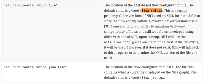

Are you sure you are removing or replacing a flow.xml.gz.  Apache NiFi 1.19 uses the flow.json.gz.
The flow.json.gz is auto generated from the flow.xml.gz if and only if the flow.json.gz does not already exist at startup.

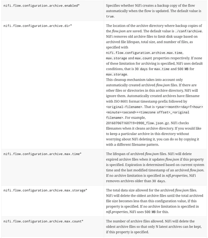

Archive can be enabled for the flow.json.gz as part of the following properties:
Archive of flow.json.gz only happens when a configuration change is made on the NiFi canvas or via some change via NiFi rest-api interaction resulting in changes to datafow(s).  Archive when enabled does not randomly generate archive copies of the flow.json.gz.  Only happens with each change.  So if you are seeing an archive of teh flow.josn.gz generated every few minutes in the configured archive.dir?  If so, then changes to your dataflow are happening.
