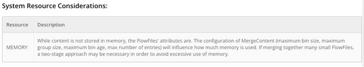

Here is example form MergeContent:

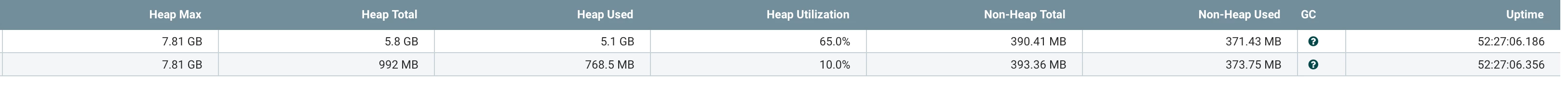

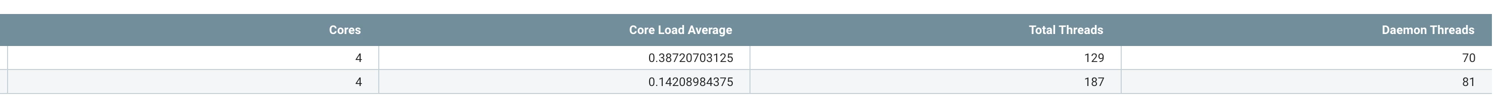

Here’s some extra info:
jvm - high utilization is the primary node
core load is normal
