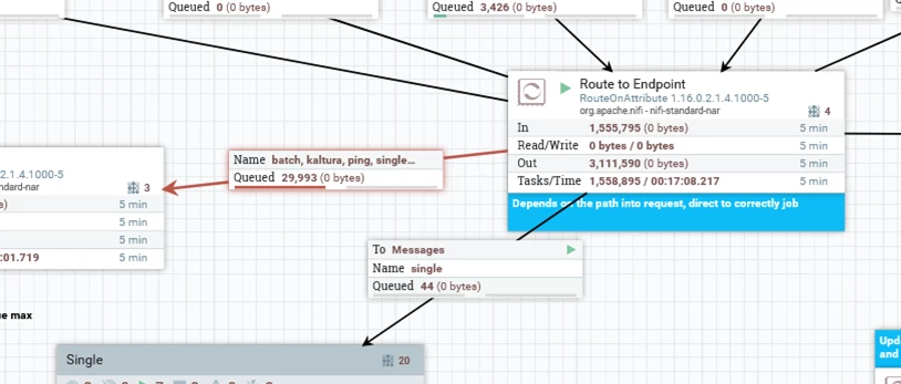

there is a single point of the flow where a queue is filling, and backpressure is being applied: a logattribute to register the ips of the incoming requests:
Apart from that, there are roughly 5000 flowfiles flowing in the system at a given moment when were processing a steady flow of events, which given the fact that end-to-end latency is approx 1second, seems acceptable.
 Have you tried increasing the "Run Duration" property in the scheduling tab of the LogAttribute processor?
Sometimes setting this even at 25ms can considerably increase your flow's throughput. I'd recommend playing around with this setting and seeing what works best.

Increasing the Run Duration of the log processor eliminated the queued flowfiles and that was good.

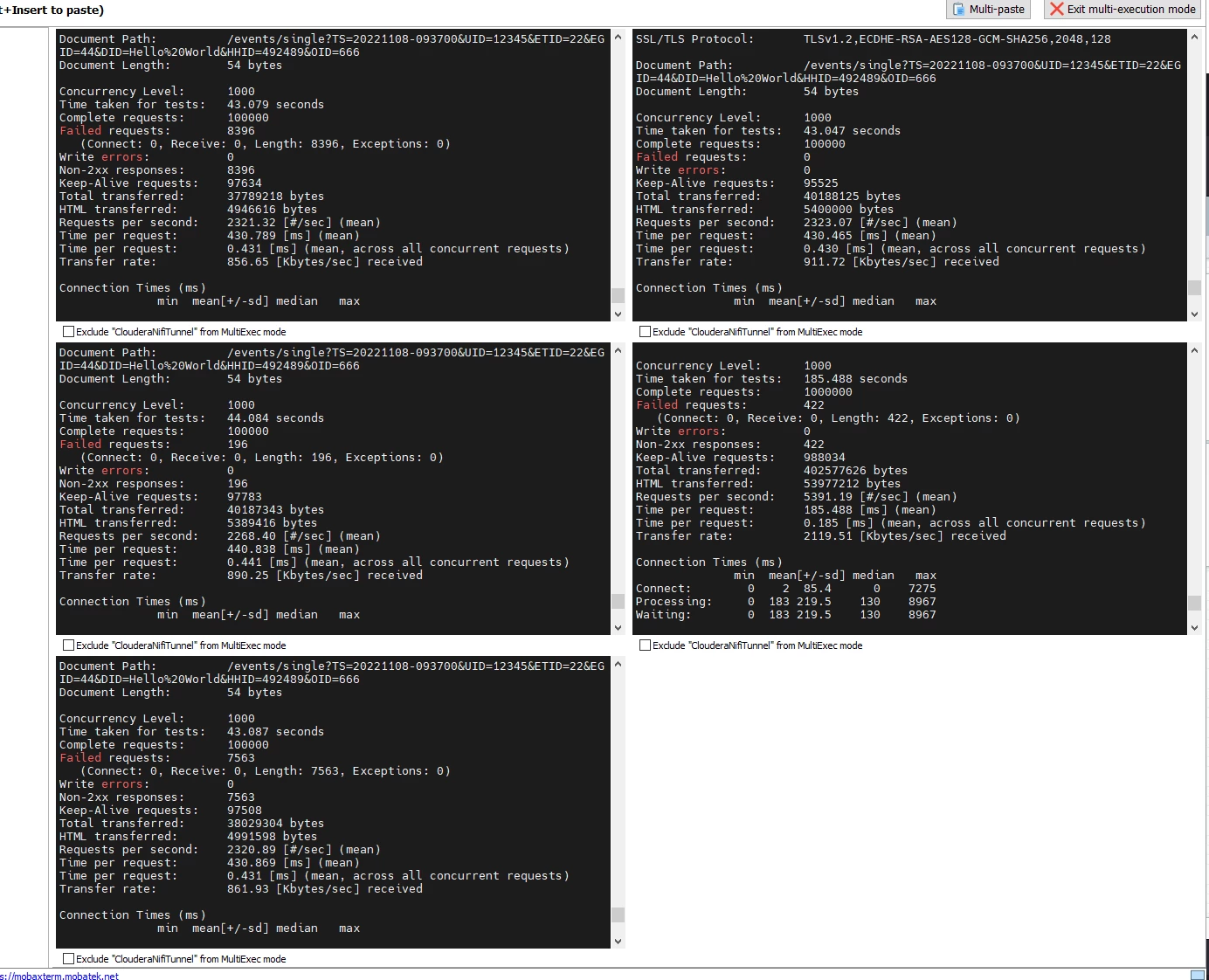

I am using 5 clients with concurrency level of 1000 simultaneous requests per client and at a particular time there are about 5000 flowfiles being routed. This means that there are several dozen requests or a couple hundred requests per queue at a particular time. So in my opinion there is no backpressure being applied (the queues are configured to start backpressure when 20k requests are queued).
I am not sure about the HandleHttpRequest... it could be... but requests are not being dropped, as during the tests i only see several hundred failed requests in 500 000.

Perhaps the source of my own confusion is that I do not know how Apache Benchmark works.
Considering only a few hundred requests get dropped (out of hundreds of thousands), this would mean nifi is indeed able to ingest (almost) all the data you send it. As such, I think we can rule out the load balancer and ListenHttpRequest processor.
You expressed that you don't believe any Back Pressure is applied in the flow because the queues between processors are configured to contain 20,000 flowfiles at once whilst you only send about 5000 concurrent requests (this also confuses me - 5000 concurrent requests, but at what rate? every second?). The way you described this sounds odd to me - whether a flow has any backpressure is not a function of its configuration and the data ingestion rate. Rather, I expected you would visually examine the flow as you run your benchmark test and check whether at any point in the flow the queues fill up and turn red. Could you verify that this is how you checked for backpressure?
If you claim that no queues get filled up in nifi and no requests get dropped, I can't think of an explanation for how the req/s rate changes. No Back Pressure implies the flow is never under duress, and no requests dropped means that all requests that get sent are processed. Again, perhaps my lack of understanding is due to not knowing how Apache Benchmark works.

I have not expressed myself correctly. I believe there is no backpressure, as I confirmed visually on the nifi UI. On the upper banner I see there are globally about 5000 flowfiles circulating at a particular time. I see some of the queues have 20, 50, 100, 200 flowfiles waiting at an instant. The queue that has more queued flow files is the kafka producer processor, that has about 2000. I believe these quantities are not sufficient to trigger backpressure-caused adjustment of scheduling of tasks.
Apache Benchmark sends concurrent http requests. In this case, i set each of the 5 client instances to send each 1000 requests concurrently.
I have thread pool sized to 96 and assigned 16 concurrent tasks to all of the critical path processors. Despite this, I get a low core load average (between 2 and 7), the disk's IOPS are in the dozens per second (the maximum that the disks allow is 3000). I'm all out of ideas at this point. 😄
