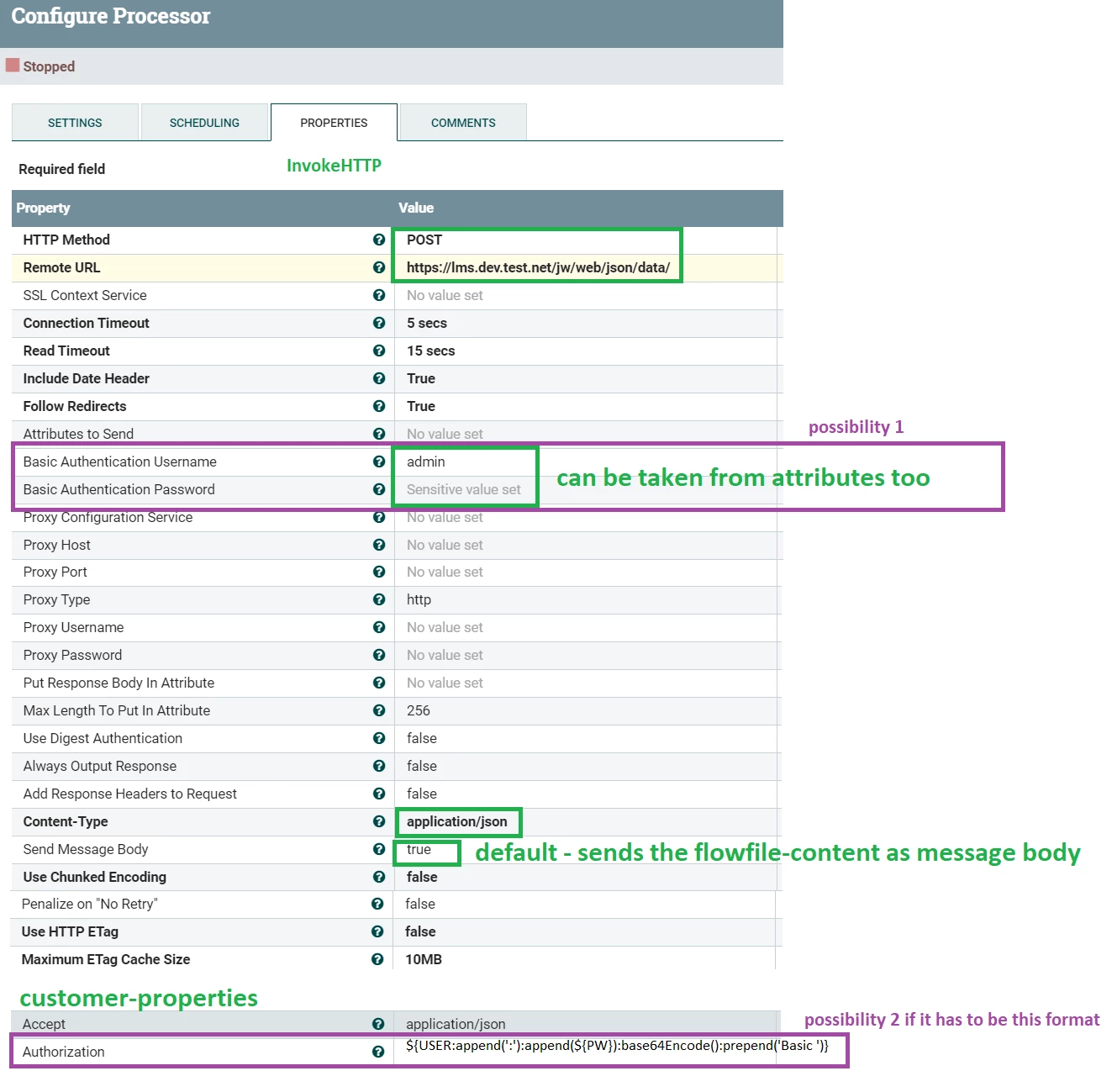

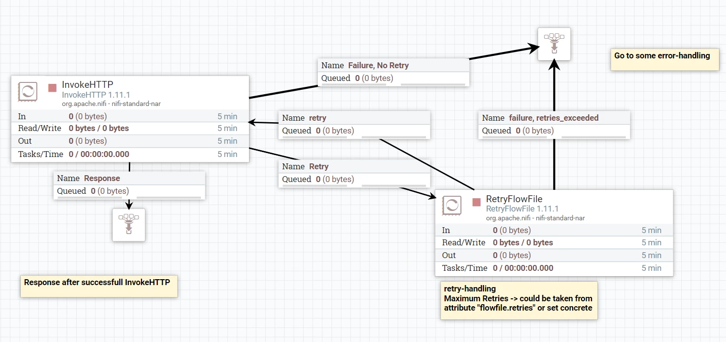

@GMAN  Here is my try to help you further.
flowflow
Look at the picture of the InvokeHTTP.
InvokeHTTPInvokeHTTP
From my experience most options can mostly be left to default values.
Your Json-body should be fine and will be send with the request.
Remarks:
- Authenticaton/Authorization: You have to try the two possibilities I know. For the second you have to add custom-property "Authorization" with the plus symbol on the right above.
- Accept: Concerns the response format not sure wether you will need this.
Maybe you can first build your request in Postman and after successfull execution then click to "code" -> "HTTP". There you can see the details needed for the request.
In the "Settings" of the InvokeHTTP you can autoterminate the "original" flowfile.
For "Retry" you can use the shown processor with default values.
All "Failure" or "No retry" go to some error-handling.
With "Response" you can go further in your flow.
Hope this helps you to come forward.
