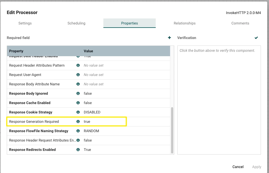

I would avoid putting a lot of data in the flowfile attributes due to memory concerns. However, what you could do is change the property in the InvokeHTTP called "Response Generation Required" from False to True
No matter what the status code of the HTTP response is , it will automatically get routed to the Response relationship with the full content of the response in the flowfile's content along with the response status code in the flowfile's attribute.
You could then use a RouteOnAttribute Processor to filter for certain response codes and you will have your full response in the content of the flowfile where it should be 🙂

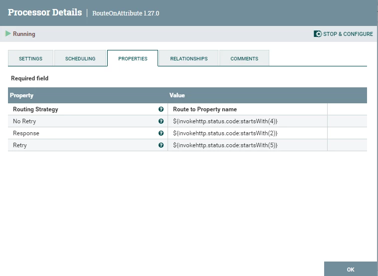

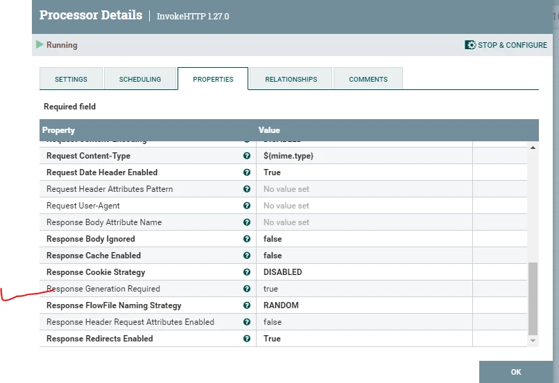

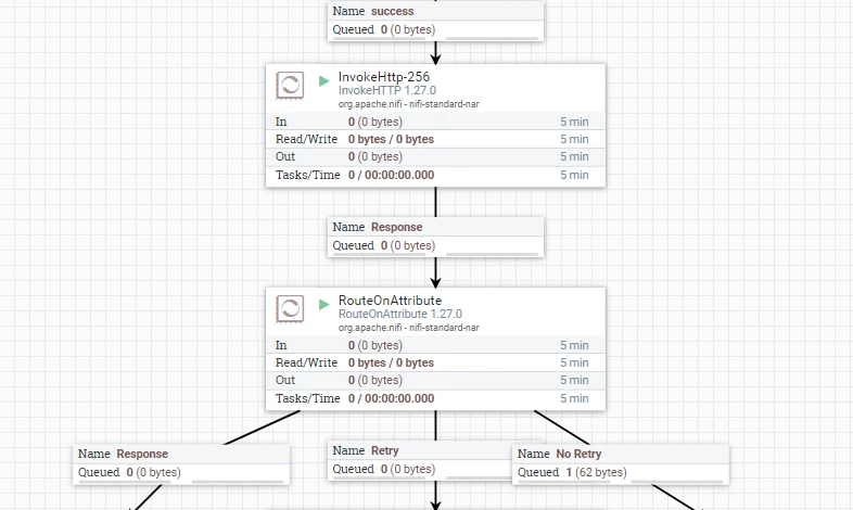

rajivswe_2k7
Silver ⭐️⭐️⭐️
Oct 23, 2024 5:26 AM UTC
rajivswe_2k7_0-1729661081105.pngrajivswe_2k7_1-1729661116041.pngrajivswe_2k7_2-1729661170436.png
